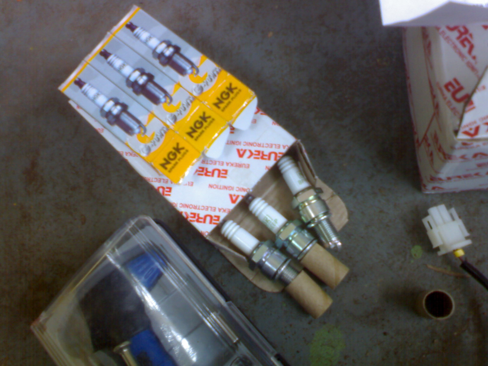

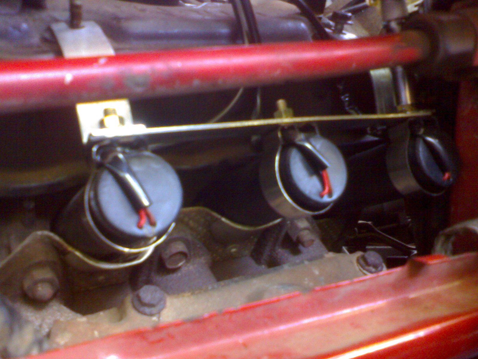

Friends, am dedicating this thread to the carb-car owners. [cheers]
This is a useful modification you guys can do. My car became very smooth in driving, less engine vibration and noticeable increase in pick-up. Now no need to bother about the CB point and condenser replacement.
The kit installed last month which I ordered from Mr. Kiran Bhide who makes the after market ignition kit for the carburetor cars, situated in Mumbai.
It includes MPI coils, Pulser coil plate(replaces the CB points), Ignition Module, Magnetic reluctor, NGK spark plugs.
With the help of the workshop friend I installed the kit and tuned. The result was just amazing. The car needs only half crank to start.

After fitting this kit, the first thing I noticed that the car needs only a half crank to start. No more miss firing. Smooth and very responsive acceleration. You can feel that!!
Forget about the CB points, those make your car stall sometimes because of the wear out.
No disadvantages faced. I installed it 2 years before, haven't shown any problem ever since. You can go for it! [;)]
