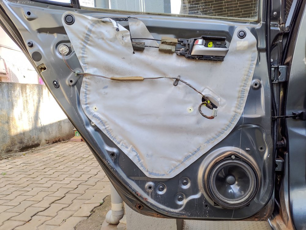

I got this product last year and now I got time to review it here. Three years ago my friend had bought CTK brand sound dampening sheets and we installed it in his Maurti Baleno. It drastically reduced the NVH levels and he was very satisfied. Later I bought it too for my car but Dr.Artex brand from Amazon and it cost me 7k for 10 sheets. It is also a reputed brand followed by CTK, STP and etc. Thickness as per specs is 2mm and butyl quality is good as CTK but aluminum layer is little soft so it blends easily on curved surface or bumps; CTK's aluminum is hard and we need to put more energy on roller tool. Though I'm not sure which is better in terms of performance. Anyway, along with damping sheets I also bought Bapna brand closed cell foam roll (Rs.800/-) for applying on plastic door panel but I guess it was useless because foam sheet will be light weight.

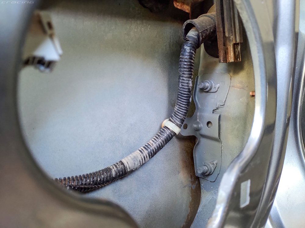

Next thing comes installation part which was way tougher then my friend's car because his was new car and mine is 13 years old so there was loads of dirt and several rust spots. I was only able to do one door a day and even skipped in-between due to hand pain. Work done each day was pulling out the door panel, removing factory plastic sheet, removing its butyl tape mess, cleaning the door, repairing rust spots and finally applying the damping sheet inside the door then filling the holes outside. I have also applied the sheet inside rear fenders and little bit to the trunk holes. Used 8 full sheets out of 10.
