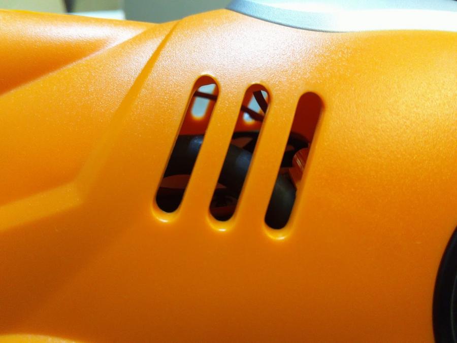

Upon casual observation before using the machine, Noticed that once of the wires was getting caught in Fan blades. So much for QC. A simple oversight could have caused the wire to be snapped off or fan blades broken.
Whats a DIYer to do? Used long needle with thread and tied it up so that the wire is held away from fan blades. Perfect-

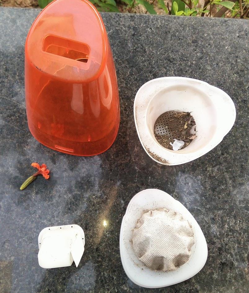

The Vacuum Part has decent suction. It picked up lots of loose dust from my Safari floor. I can also pick up small stones and sand. Here is the dust estimate from mildly dusty 4nos floor mats-
All these parts are washable. So washed them and made clean.

7. The filtration provided on Vacuum side is nominal (Just a felt cloth) and not a proper HEPA filter. You can see that the motor and impeller have become dusty with just 5 mins of use. It could be possible more dust will accumulate inside motor over time.
