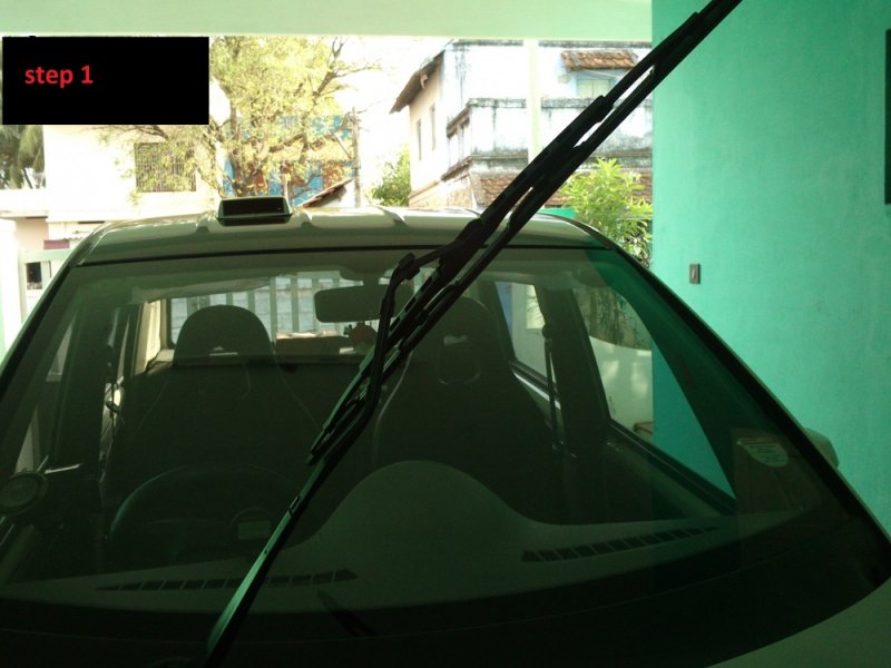

hi, i recently bought hella premium wiper blades for my nano online . i thought it is a tough job. then saw some youtube videos for replacing the wiper blades. im sharing it here as a DIY. hope this will help you
STEPS:
Step1 : place the wiper upright.
step2 : gently press the plastic lock release in the wiper adapter
step 3: move the wiper blade downwards.
step 4 : move it to the side little bit and remove by pulling it upward
you are done removing it.
in order to fix the new wiper blade,
first check the aftermarket wiper you bought has the right adapter for your car. i got 3 adapters with the hella premium blade.
follow the steps in reverse to fix them.
please note : some pics are from my friend's estilo and it is used with his permission
