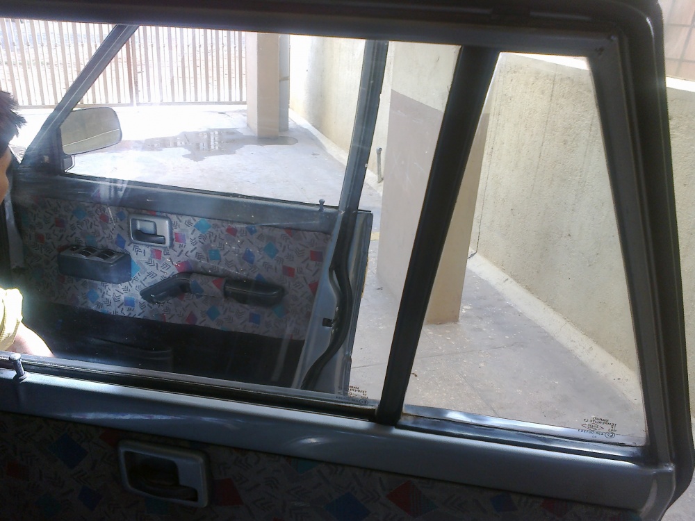

Picture taken when photo installed..
Need to cut the sun film at the corner of the glass and start pulling it slowly..
