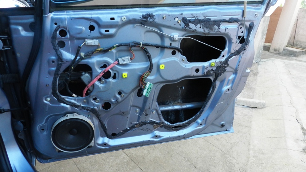

Friday being holiday, started the work early in the morning (by 6am) to escape from hot sun. Removing the door pads took around 1 hour, then realised that I haven't taken any snaps![Frustration [frustration] [frustration]](https://www.theautomotiveindia.com/forums/images/smilies/Frustration.gif)
Took few snaps after removing the door pads and the plastic cover on the door. Wiped-off the black paste (to stick the plastic cover) using a old CD. Never thought that wiping and cleaning that black paste could take me 3 hours. That was very sticky and consumed my thursday's news paper + 2 CDs + around 1 sq.m of cloth.

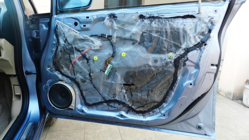

Started the job again by 6.00 pm. Inside the door I could find lot of dust and few plastic parts (plastic inserts to hold the wires) fixed them in place again, taken the car to nearby puncture shop and cleaned the door inner with compressed air.
Cleaned the water vent holes and wiped the sheet metal area with wet cloth.
Taken out the mates, cut them into shapes matching the profile. Applied Fevicol in mats as well as the door and let them dry for a couple of minutes. Pasted them and given a gentle press.

Sorry guys, I could not click detailed snaps, as I stay alone and no one to help me / click. Front LH door is the only snap that completely damped. All other snaps were taken during work-in-progress. On all 4 doors mat was pasted in the similar manner as the front left.

Have a look at the black paste, I spend most of the time in removing them
See how dirty is the inside. Sharp edges tasted my blood while cleaning them.

Front LH door after COMPLETE damping

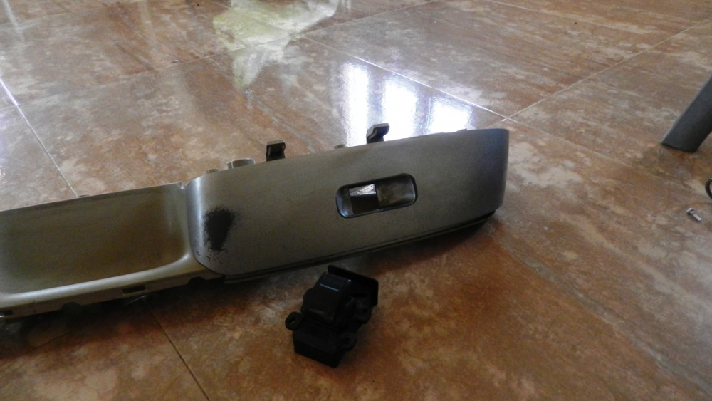

Arm rest and power window switches removed for cleaning
