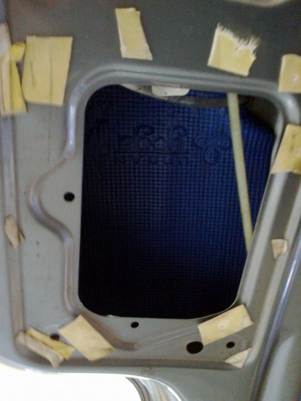

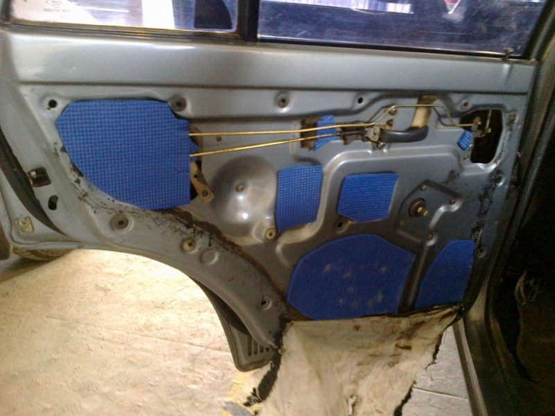

Hi Friends,
I know professional damping of your car is too costly..
But for people like me who are interested to dampen your car with low cost here is an method..it is totally a DIY ..
I have used Yoga mats to dampen the car..though this not effective as professional damping. But it serves the purpose..
I have presently done it on the hatch door and both rear doors, result is good. No rattling from them..
Materials used..Yoga mats - 2 no's (300rs each) 1 Fevicol SR gum to paste them (50 rs)..
Here are some pic's.. Please share your comments..[;)]

Varun did you use any double side tape or only fevicol sr gum?
I have only used Fevicol SR..
Nice DIY.I dont know wheather this yoga mat is available in kannur.I seriously want to dampen our swift with these yoga mats.The the sound deadning materials normally used is way too expensive.One doubt I have is that effect of the super glue,will it be effective in the long run?
Thanks, Yes this glue is a good one.. It will last long. Another advantage of this glue is it won't make stains or marks like fevi quick.
Its cheap too..

Re: DIY - Cheapest method of damping your car
Thanks again Varun, This will be my weekend project!
What's the thickness of your yoga mats? since there are too many qualities available now a days. The gum you mentioned "Fevicol SR" is this the same light brown coloured gum used by carpenters to stick the laminates on plywood?
Good pictures, gives excellent clarity on what exactly I need to do.

But with moisture and friction with the door lock levers , will it reduce the overall effectiveness with time.
Then this might end up being a quarterly exercise.
Not good for the inner door panels i guess.
What do you suggest to avoid this problem? Is there any other glue which can be recommended to increase the life of this DIY?
I am not talking about the glue but the mat.
I have seen those mats getting worn off within months with friction , collecting dust and holes developing in Them in my gym.
Hence the doubt.
