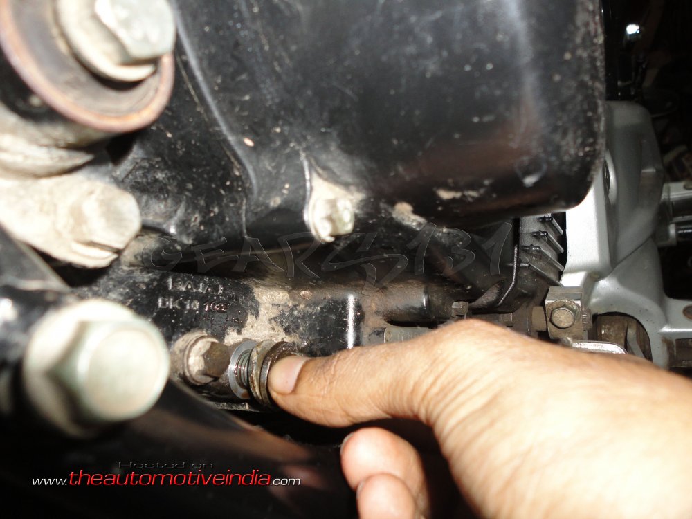

Open the nut marked in red with the help of that tool. Dont remove it fully; just loosen it.

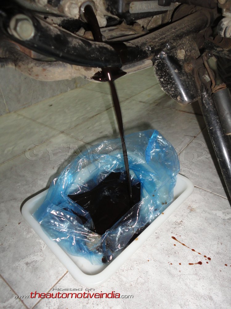

Put your bike in side stand. Place a container to collect the used oil. I have used a plastic bag also, to avoid mess.
Now remove the nut. Let the oil flow out.
Now tilt the bike more if possibe; in other words try to remove the oil fully.
Place the nut back on the place.
Make sure the nut is tight enough. Put the bike in main stand again.

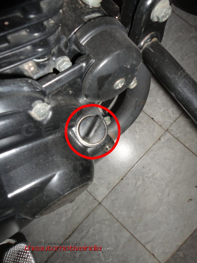

Now open the inlet, from where you can topup the oil.
