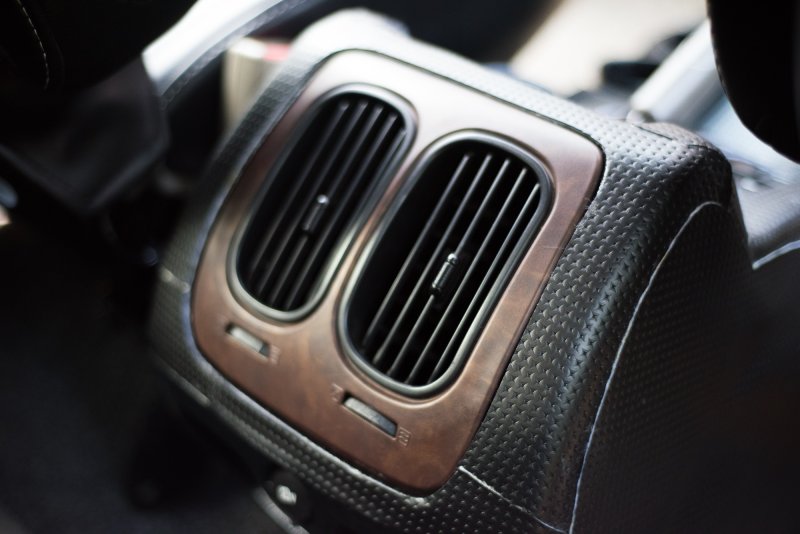

Firstly painted all the storage compartments on the panel. The cover around the gear stick was showing its age. Carefully pulled off the frame on which this cover was fixed around the gear stick. Stripped it off and got a new cover stitched at a local tailoring shop. I made sure that he double stitched in white matching the seats.
Covering the entire panel around the Gear stick/ Miidle AC vents took the entire day, with carefully making newspaper templates, cutting the mat and then gluing them on to perfection. Taking the entire panel out would have made the work much easier but I didn’t want to take any risk as I wasn’t sure if they would fit in back properly after work. Really impressed with the output and the entire area, now, has transformed in to some thing different from the usual.

Typing this from Hyderabad now. Covered some 1500 km after the DIY. Totally satisfied with the job. Since the material is quite soft, there is no rattle from coins/phones etc, looks great too.

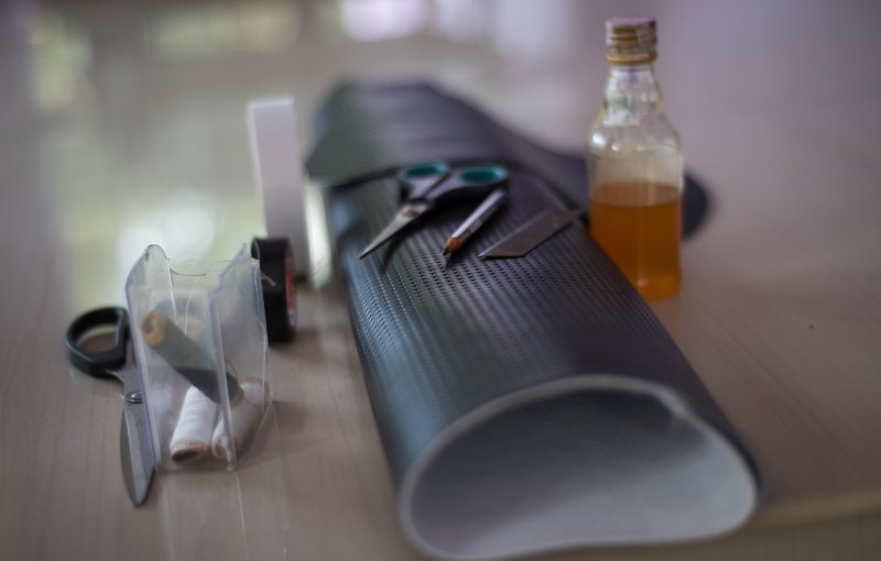

Materials used:
- A good quality black Rexine mat, 1 meter
- A solution/ glue purchased from the same shop
- Super glue
- Cutter/Scissors/ Metal ruler/Pencil
- Black Paint/brush
- Newspapers for templates
