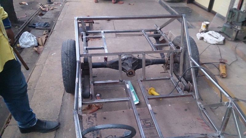

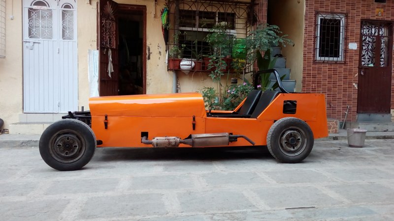

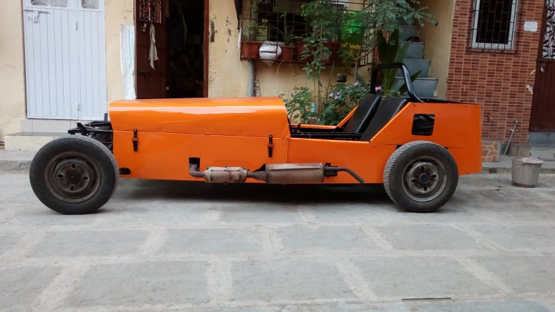

Yes it was labour intensive and lots n lots of learning.
Since I am not from engineering background I had to learn a lot. I mean had to start from A B C of vehicle dynamics, suspension design, space frame chassis design etc. Even I had to learn basic software like solidworks to design the chassis, I designed about 37 chassis and this is 37th design which was finalised.
The dimensions were taken from photographs of the real car (Caterham 7), I put the photographs in 3D CAD software and roughly calculated the dimensions.
Technical Specifications:
Motive for building : Pure passion nothing else
Donor Car : Maruti Suzuki Omni/Van (MPFi)
Chassis : Space frame chassis
FWD/RWD? : RWD
Front Suspension : Double wishbone with coilover
Coilover : Honda Activa - rear (hehe)
Rear Suspension : Parallel Leaf Spring (Yes that is true, I think this is world's first locost 7 with parallel leaf)
Steering : Rack and pinion (Manual) from TATA Nano
Engine : 800cc
Brakes : All drum brakes
Material used:
1 in X 1 in 16 gauge RHS were used to build the chassis
sheetmetal used is 20 gauge (patra) - for making panels
bonnet is handmade
Still work under progress..... office se chutti le leke kaam chal raha hai.
Work will resume after monsoon, may be by september end.

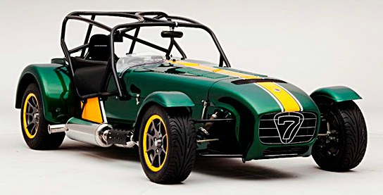

Additionally, you may opt to fabricate a roll cage for safety as in this pic, where the IRVM/ORVMs can also be mounted(another safety aspect):

Hello Everyone,
I am building this car, but now I don't have enough money to finish the car. So selling it. It's my personal project (not a college project), If anyone is interested kindly let me know.
What is remaining?
Fiber moulding part is remaining, which is out of my budget.
You will have to make a Nosecone, Fenders and a rear cover. You will have to change the tires (may be rims) too, battery is required.
Please contact if you have keen interest in buying this unfinished car and may be want to complete the project.
