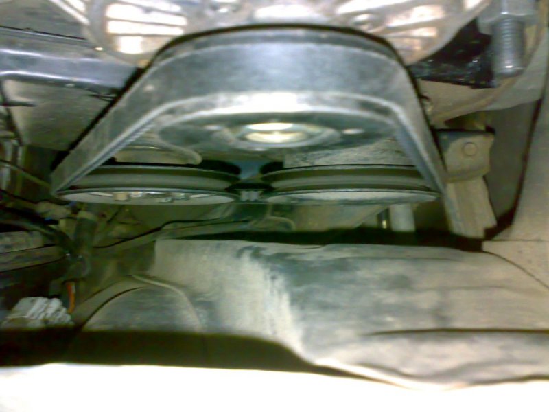

Today's Update,
Just completed the work in my car, it working fine, with all the load I am able to get 13.60 in idle rpm and if I just increase\accelerate a bit it raises to 14.20. I think its more than sufficient.[;)]
Tested with full load.[evil]
Headlamps 120\100 watts,fog lamps 55 watts,blower, front and rear wiper, engine\radiator fan, brake light.
The alignment is more perfect than the first car.
Here are some pic's taken at the time of installing.
Sorry for the picture quality .
I will upload the pictures of the mount and other wiring later.
