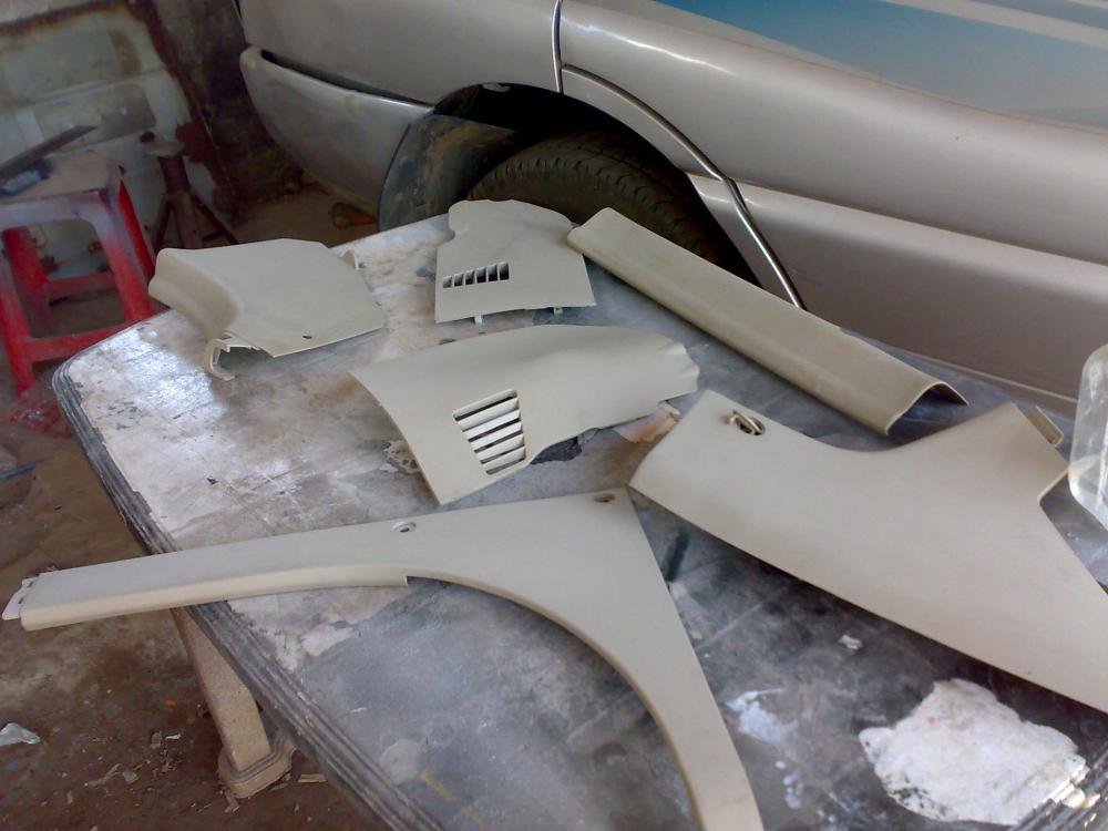

The procedure is quite simple to type and say,but,it requires careful handling of the parts.In simple words,remove the parts separately,paint those parts as your own theme,and then fit them accordingly without any damage to a small screw.
The pictures attached are
1)The plastics which were removed,and waiting for the plastic primer to be coated.
2)The 'A'-pillar and the plastics of the dash board,that is the AC switch console and other parts getting ready for matte black paint.

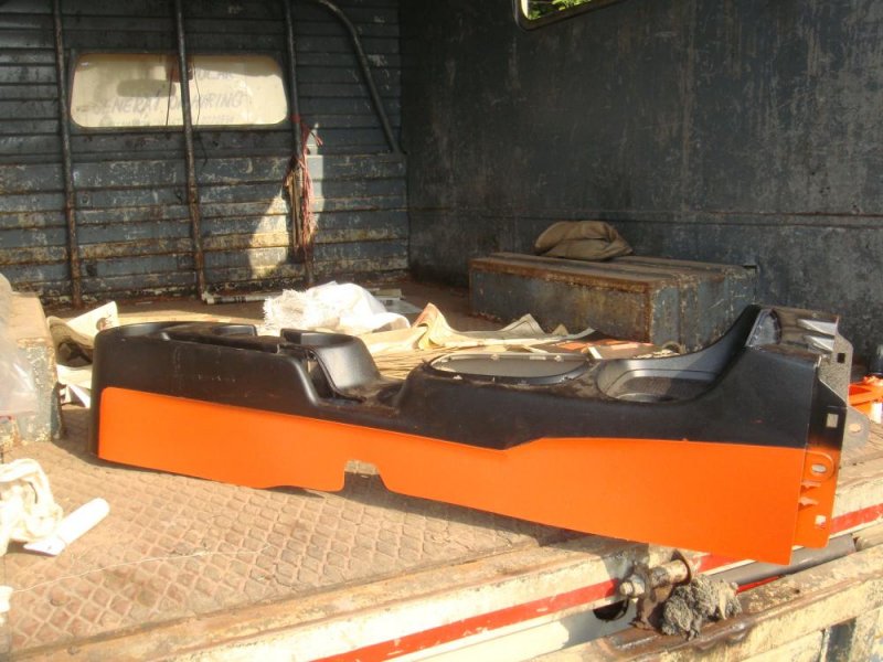

4)The gear console got painted to matte black.
5)The ORVM adjusters enclosures got painted to metallic silver.
6)The gear console's matte black got dried and then coated with paper,and the lower portion painted with custom Orange paint.
