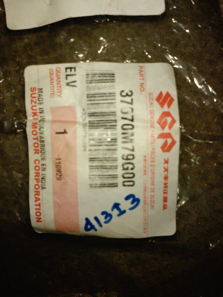

Again my Alto did not have door sensor switches for back doors. Hood light on/off only with front two doors.
So no light indicator when back door/doors open
I fixed new door switches for back doors and now hood light on / off for all 4 doors.
1). Got two door switches from local dealer
2). Remove the side beading and plastic covers near seat belts
3). Wire connected to new switch
4). Other end of the wire connected to existing front door switch
check pics
-Lakmal-
