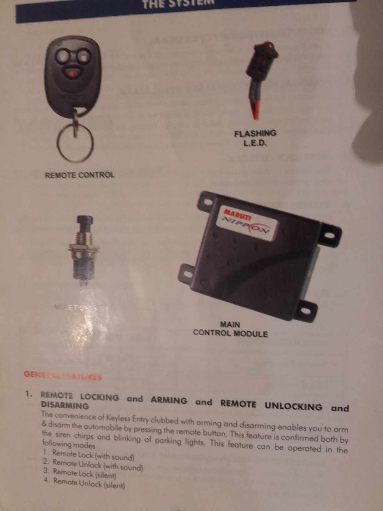

I am attaching below the details of the Nippon locking system in my Esteem. The same locking system was used in Wagon R and Alto. I hope it helps.
@Viru, The failure of alarm could be due to wiring malfunction. My Esteem too had it number of times. The siren might not necessarily be at fault. The locking system has warranty of 3 years from date of purchase so in your case, you might need to get it replaced by payment to Maruti or even in aftermarket. In case you plan to go the after-market way, I suggest you may use the Auto-Cop system. About the cost involved, If you may use the ASC/Dealer then it may be anything between 5-6K and if you go to after-market, then it may cost Rs. 3-4K
