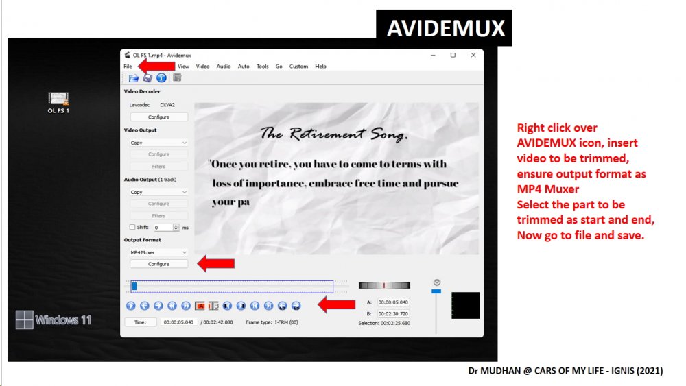

VIDEOS
I felt, the audio of a video has better sounding than from the regular pure audio format, as the Audio part plays even though video play is restricted while driving.
The only issue, we should know how to make our favorite videos play in the best compatible format.
After some research, I found these simple steps to make it happen.[:D]
For this, you need three softwares for doing in MS Windows, which are legally free fortunately.
1. MEDIAINFO , helps to find whether your media will definitely play . LINK
2. WINX-YOUTUBE-DOWNLOADER, helps to select and download the compatible video that can be played. LINK
3. AVIDEMUX, helps to trim the compatible video if you want to cut the unwanted part. LINK
The following screen shots will guide you:
NOTE:
Audios are best @ 320 Kbps in AAC or MP3 formats.
Videos are best @ Resolution of 1280X720 (16:9), Frame rate up to or below 30 FPS, and coded by AVC. All others will never play or leave only Audio or have jerky video lag issues.
The inbuilt audio in video must be as - AUDIO STREAM property @ 128 to 180 Kbps/44kHz/2 Channels AAC LC. - should be indicated by Mediainfo.(Refer Picture)
Set in the EQ - Bass/Mid/Treble to your preference
Enjoy your favorite Audio and Videos to its best.[cheers]

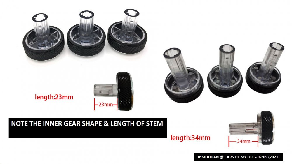

Right from the first day the IGNIS Zeta came to our home, I started exploring the possibilities of changing the HVAC (Heating, ventilation, and air conditioning) Knobs which looked to me as cheap & dated.
I did the same thing to my ALBUS, the third generation facelift Honda City that was appreciated and followed by many Honda city lovers. READ MORE
One thing that I noticed is these AC CONTROL KNOBs are used in all versions of IGNIS worldwide and many other models of Maruthi & Suzuki till date.[sad]
Pulling out the knobs made me to study the gear design and, I started searching compatible Modern Knobs that reflects better look & attractive night illumination.
Finally found out something compatible in AliExpress and no other source. Unfortunately, it was not possible to import as this site is presently banned in INDIA for individual buyers.[cry]
LINK: Car Air Conditioning AC Knob Heat Control Switch Button Knob For Suzuki Swift Ciaz Splash Mazda VX-1 ERTIGA 2017 Proton
Though many such things are available in Amazon.in for an expensive amount through Shop & Ship methods, imported via other countries like Malaysia /USA. BUT, this one meant for Suzuki Model Cars was not available anywhere in Indian online sites.
My daughter helped me by sending from Australia, though it became little expensive @ 31.5 AUS Dollars (11.5 Cost + 20 Shipping).
It took almost 2 months to reach me despite it was an Australia Express Post due to pandemic.
At last, I got it.
The quality of these knobs are excellent. Honestly, the OE knobs are of poor quality that disappointed me very much.
The gear design matched but not neither very tight nor loose. May be I should have tried the 34 mm type, nevertheless, I fixed it by adding a thin paper strip inside the inner clips.
Only thing that still to be solved is, I could not pull out the original center FAN knob as it is very tight and I am afraid of using extra ordinary force, so left out as it is already a rounded, decent design. IF ANYONE KNOWS, PLEASE GUIDE ME THE WAY TO REMOVE IT.
My IGNIS has now an added beauty in the interior that makes it UNIQUE again.[cheers]
