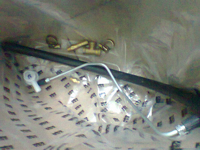

The above contents come with the kit itself. When you specify to the shop keeper that you need to install (mods) it on M800 he gives all this connectors etc
