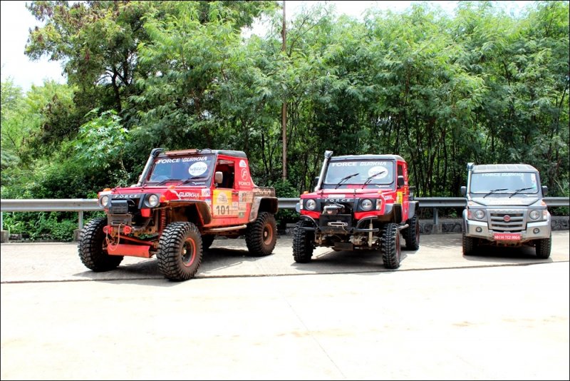

Behind the scenes of the RFC Winner 2015 - Force Gurkha
RFC Gurkha 2014 vs RFC Gurkha 2015
Back in 2014 too they had swept the top 2 spots at the RFC details here - RFC 2014 link
So this time the challenge was bigger, badder and competition too was much more prepared compared to the 2014 event.
Specs of the 2015 RFC vs 2014 Gurkha
The major differences are :-
* Suspension Setup and front and Rear Axles (From Leaf Spring to Coil Overs)
* From 33 to 37 inch bigger/wider tyres
* Larger Wheelbase for stability and better approach/departure angles
Spec Sheet for Comparo
The 2015 version dwarfs the 2014 Gurkha thanks to huge tyre up-size.

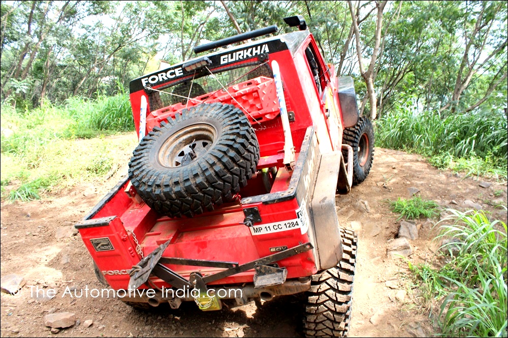

Shots from the in-house off-road test track at Force premises :-
This track was meaner than the track we tested the stock production Gurkha and needless to say more extreme. It would be a safe statement to say stock vehicles couldn't have cleared this track without incurring damage.
We were led to the off-road track, the travelers and Force One did the chauffeuring duties
The track started with a deep ditch (60 degree decline +)
It followed with a camel humpback climb - this was at least a 50 degree incline
The winch in the 2015 RFC Gurkha was COMEUP make, Double motor, capacity: 8000 lbs (the 2014 version had a Warn unit)
The humpback decline was easily over 60 degree, most of these were negotiated in first/second low. The climb done with rear lockers on as it was slippery and eroded slope.
It followed up with severe articulation tests, look at the length of the coil-overs, despite this articulation available, we managed to scrap the tire against the wheel well in certain extreme terrain
