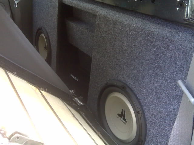

One doubt , as the sub draws lot of power from the battery we cannot hear songs in full bass when car is switched OFF right? If we do so the battery drains a lot right? So after installing a capacitor can we listen to high bass songs even if the car is switched OFF?
No , capacitor just stores for about 1 or 2 punches .
Do not hear songs in a car with engine off with sub's.
Although in normal set up like a head unit and 4 speakers connected to them is ok
yes, as ilango said, caps are used so that the subs never miss a beat.
when a car is switched off, a normal setup like mine (4 speakers + 1 sub + 1 amp) can be heard. i do hear songs in my scorpio when its engine is not running. but yes, since mine is a diesel car, the battery is more powerful too.
but in high end setups like 4-6 speakers with a 4 ch amp, 2 powerful subs with mono amp and all, its risky to play with engine switched off.
even in your setup, even though you have 2 subs, they are JBL & are connected with two 2 ch amps, so i dont think they will draw too much power. you can easily play music for atleast half an hour in moderate volume.

Fixing in speaker box calculated to the speaker gives tight punch , fixing on slab as you mention will take up the dicky space as box. It will give loose punch
