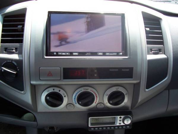

2) Double Din Head Unit:
Well known brands are Pioneer, JVC, Clarion, Alpine, etc.

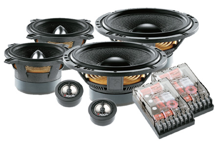

3) Component speakers: Component speakers are of two types - 2 way & 3 way. 2 way speakers consists of midbass, tweeter & crossover.

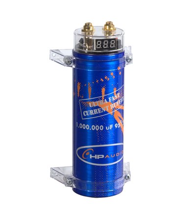

Capacitance is used to hear a correct thump in the bass.
Some times in music there is heavy bass and it draws a lot of current , when the battery and alternator do not proocude the required amount , there may be miss in punches - you can feel lights dimming to the bass punch.
To over come this we use capacitance - will store current and release when needed.

@ ilango: yes, in very high end systems, especially with high power amps & two subwoofers, a capacitor is a must.

Its not that everytime you need a capacitance, some install it as a part , some install them only if needed , Think of the battery if it has to run your hid , lots of show lights , ac , and your music system.

There are a host of ICE accessories like capacitors, lighting & many others. As ilango said, i have also seen separate battery packs for these!
Capacitors are generally used to store power so that the sub, even at high volumes play clean & tight, and never miss a beat. i hope i am right.

Yeah capacitor stores power that is the current and release when there is sudden need of it. I have mentioned in my first post itself..

Capacitor
A capacitor is an electronic component that stores and releases electrical charge. Heavy-duty capacitors are often used as a buffer zone between your amp and your car's electrical system. They store up a reservoir of power, which can supply the amplifier's peak demands (like a kick drum beat) without having to get additional current from the battery. All amplifiers have built-in capacitors, though high-performance amps use larger, more effective ones. External capacitors connect to the power cable just before it reaches your amplifier.
