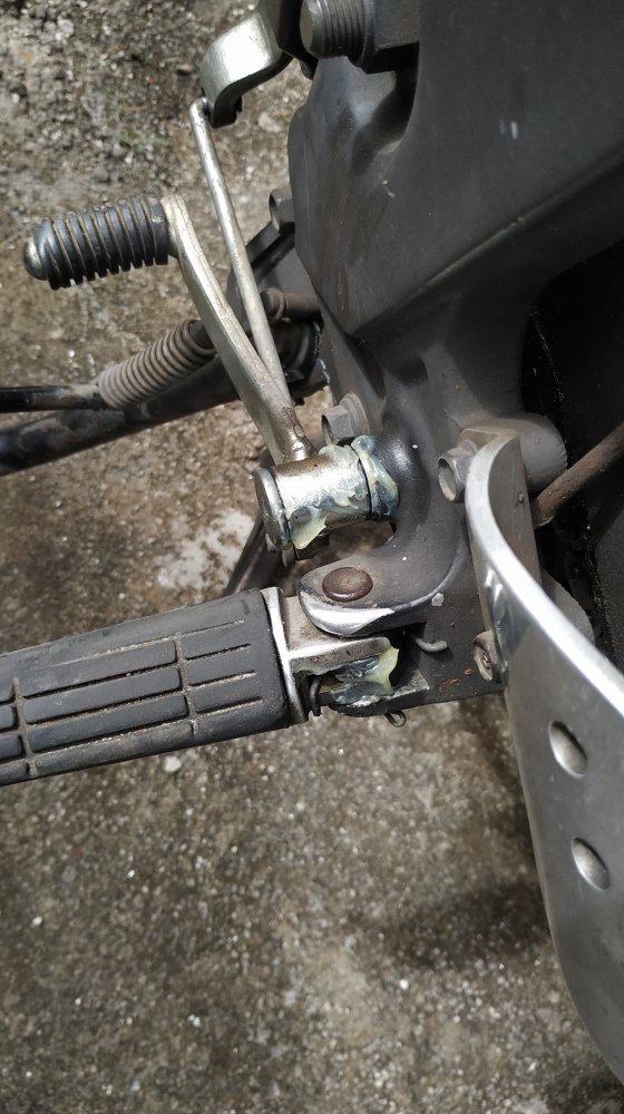

One thing I don't like about KR. Grease everywhere. Too old school.
