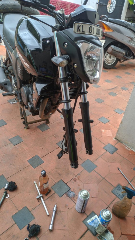

Prepping for paint.
Popped up the fork dust covers for the ease of masking.

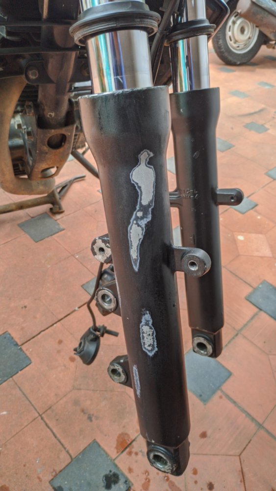

Found one of the circlips rusted.
Sanded.
Primed. Lately seeing primer reacting with old paint, which wasn't the case all these years. Both primer and old paint were Bosny.
