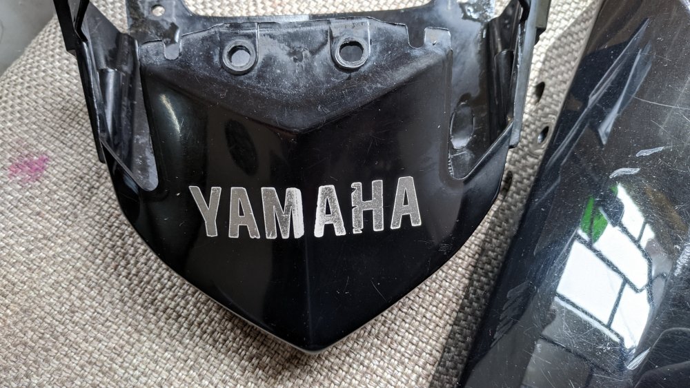

Tail panel was full of scratch and wear as well.
Worn out sticker. This one Yamaha was missing in later editions.

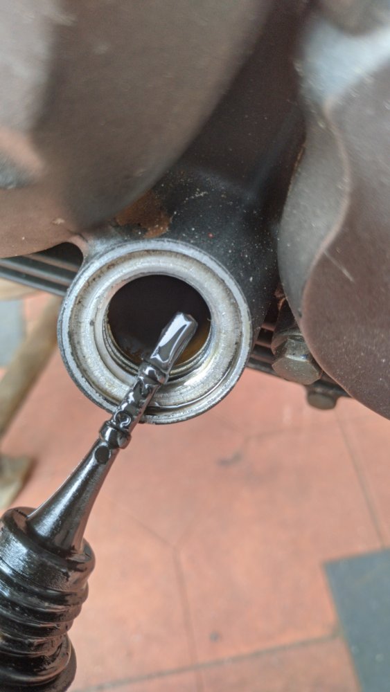

June 2020 - More misdeeds by Royal Yamaha Service
After sorting out all the misfits and missing parts by Royal Yamaha at time of drive shaft replacement, was going fine, but bike wasn't doing any mile since lock down 1.0. Had to got to wife's house, took my boy instead of Dio since there wasn't anything to haul. While waiting at signal, there was suffocating smell of burning oil and was looking at other two wheelers in vicinity to see who is the unfortunate one with blown engine. Next morning, while taking bike, there was pool of oil below and gave a shock.
Checked for the source and it was the drain bolt. That garage was infamous for ruining the threads in the engine. Feared mine had the same fate. On closer look, the crush washer was missing. 50:50 chance of thread damage.
Fresh drop 5 minutes after parking.
Then I saw the bolt half out. Immediately tightened up all the bolts. Could have paid more and transported the bike to regular mech than the crap shop.
