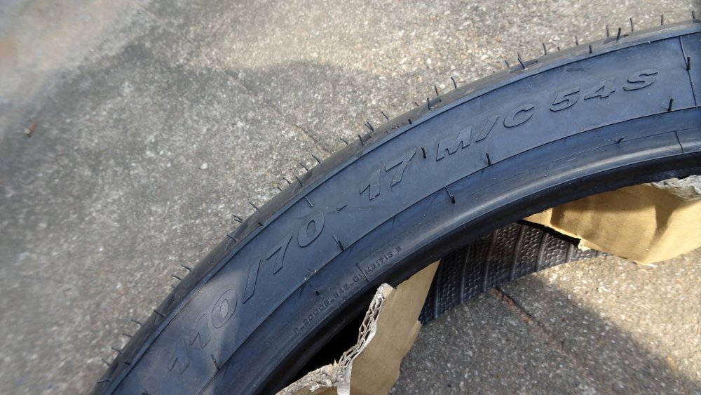

Angel CiTy
110/70/-17

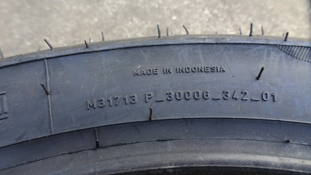

Made in Indonesia.

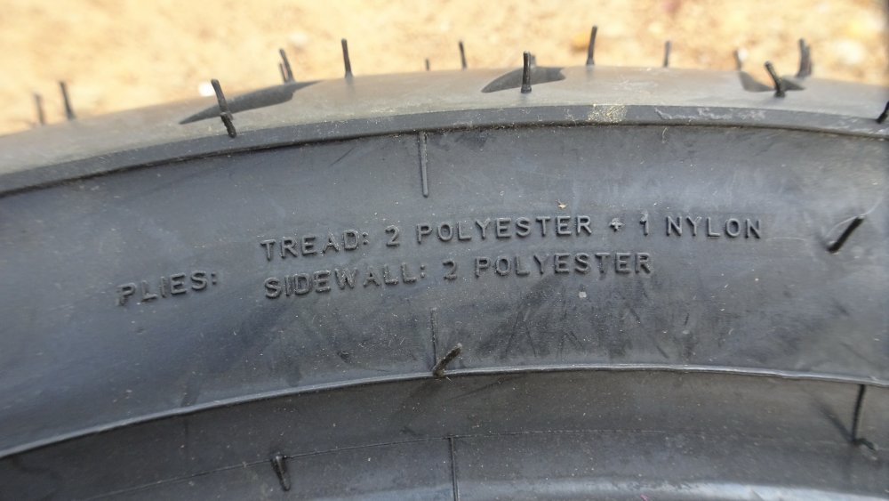

Not radial.

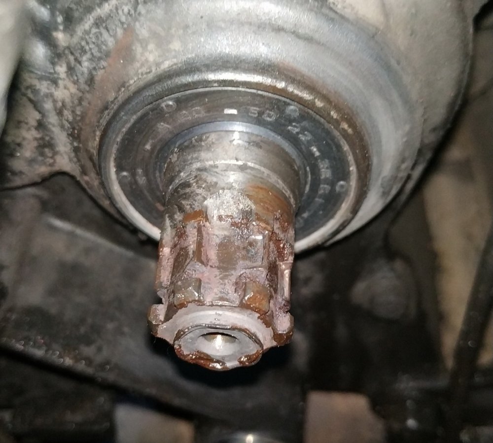

Front sprocket was worn out and making noise. Had spare one from last time. Zodix brand.
When removed old sprocket, shocked to see the disaster waiting to happen. The drive axle tooth almost wore out. Installed the new sprocket with the plans of getting it replaced next week after salary credit.

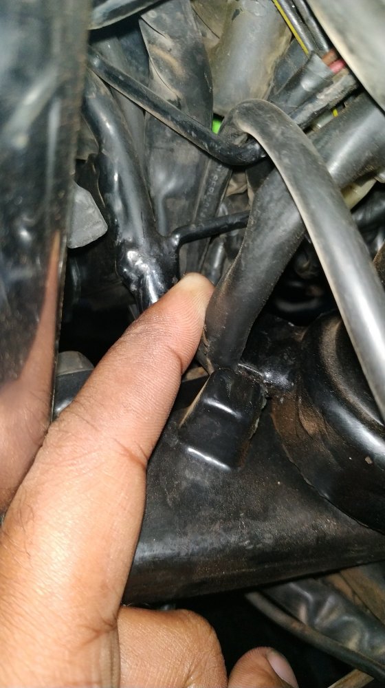

Rubber cover of the timing chain adjuster missing, leaking oil through it and causing tappet noise like hissing sound. Cover not available separately, have to replace the whole adjuster.
Loose nuts of chain adjuster.
View attachment 273699 View attachment 273700

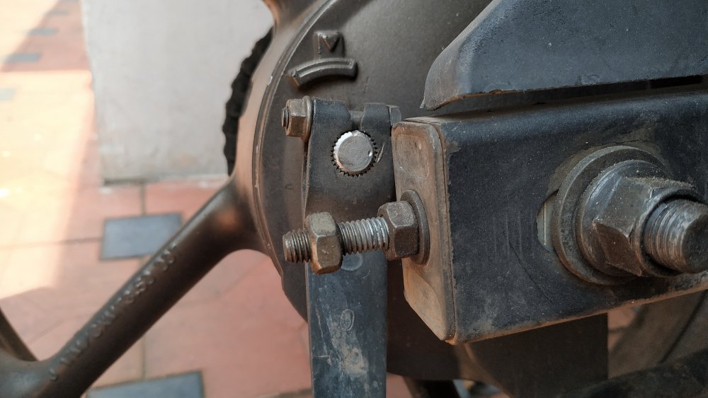

Misfitted sprocket cover spacer, damaging the rubber grommet.

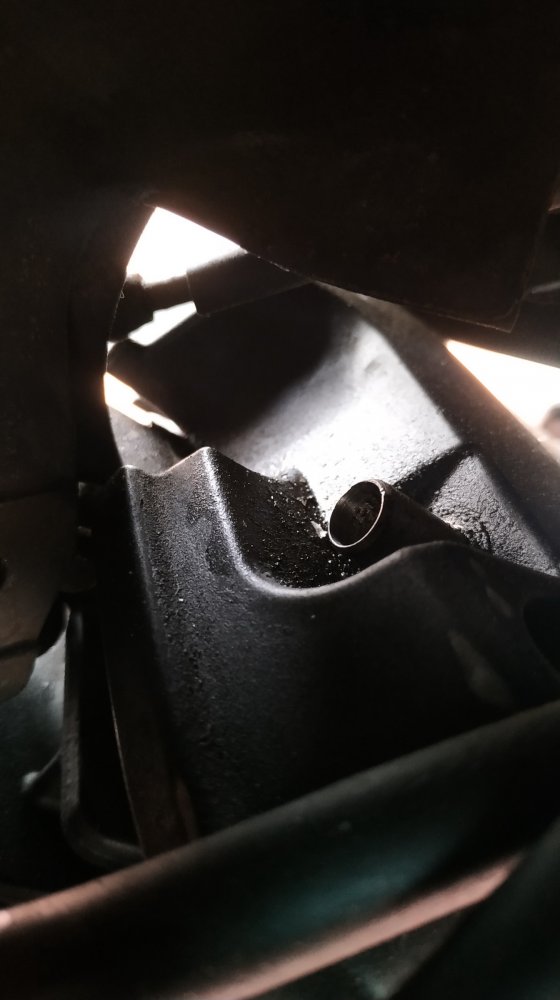

And the shittiest, disconnected (forgot to fit) engine head breather. Such a dick mechanic.

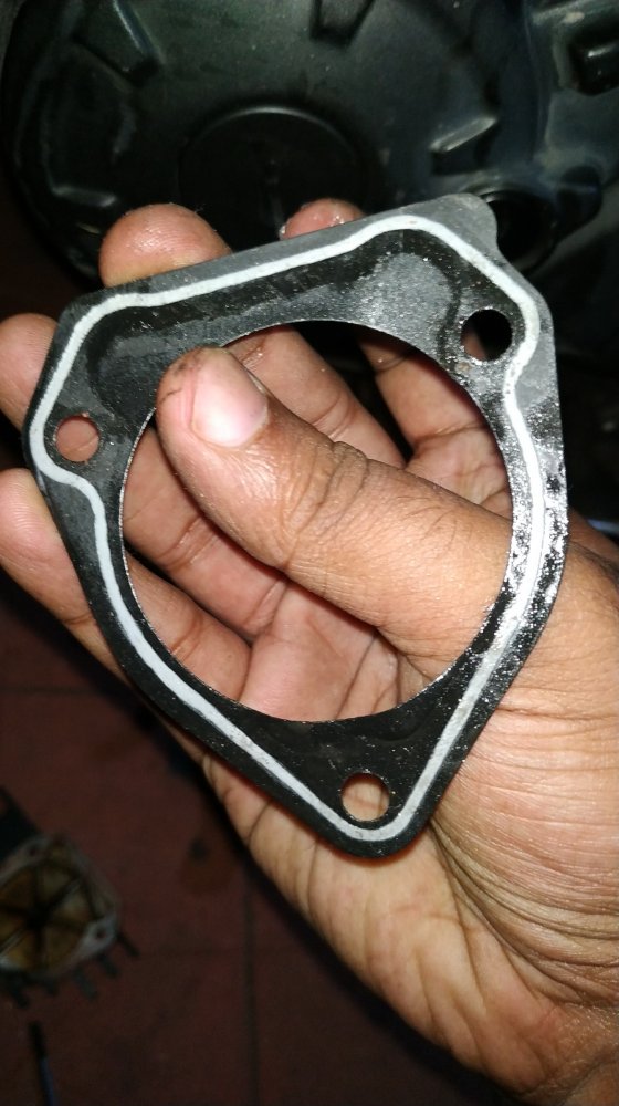

Removed the timing window and there was no sign of any sealant used though was billed a tube of Anabond. Only residue of old sealant, which wasn't properly scrapped off. Gasket was new.
Did a quick clean, but not thorough one since I have to redo it as the sealant I had was out of its shelf life and wanted much cleaner black sealant. The one I had was ThreeBond Super Sealer Clear Silicone Gasket Maker. Applied a thin layer on both sides and also the bolts and installed back. Hope it fixes the leak.
