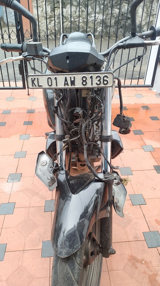

Installation. Strip off the tank panels.
Then headlamp side panels and....
and the headlight. This aids is proper routing.

As usual, was sitting idle one lazy noon after night shift and was smoking my head on how to improve the headlight throw as it started raining and absolutely blinded in the highway with no streetlights and only highbeamers. Then came to the mind the broken fog lamp lying around from @varunkumar2910 's, which was tested the whole length of India up and down [lol]
There was no clamps, and wiring ripped off.

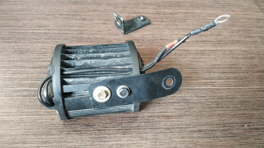

Clamp location was pretty tricky and not workable with flat or perpendicular clamps.
Scars from the spill from Himalaya's. Actually snatched from them as my sovereign.
Searched my parts bin and found this, an old horn clamp.
A pair of 8-mm bolts and washer. No identical stuff in the bin
Voila. Perfect. But the angle of mounting wold be stupid.
Comes the L-clamp. Added a nut spring, so that no loose nuts.
Final setup. Now I can pivot and adjust the angle. Up-down and right-left.

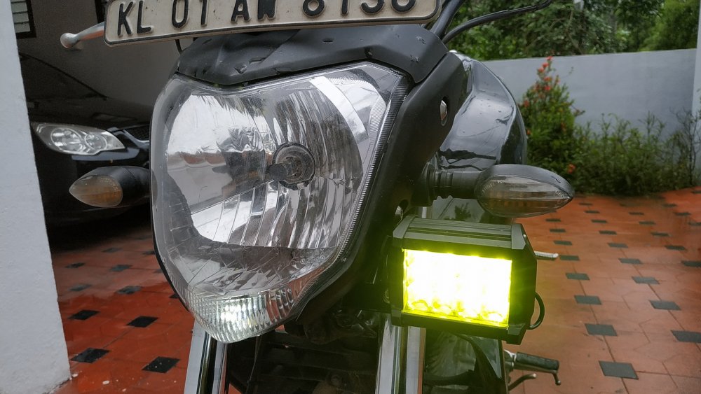

Now where to mount. Perfectly placed headlamp beam adjustment bolt.
Parts hunt. Missing parts from bin.
The fog lamp switch. Lucky to find Minda make. For all previous installs got Chinese ones, which faded pretty quickly. Cost was same as Chinese counterpart, only ₹ 100.00.
Mounted and wired.
and the final part, the relay. Had a lot of cube relays lying around. Fog lamps drew may be 2-3 A. So safer to use them.
Wiring. Drew positive from horn wiring, which came proximal to the front end of the tank, so no headache of drawing from battery again and again, only issue was fuse blow will kill both horn and fogs. Wired such that fog lamp will only work when park lights are ON.
Done and working perfect.

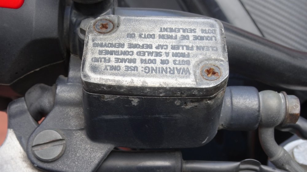

Condition of master cylinder. Rusty as always and screw screwed up by mechanic last time.

The master cylinder. Clean it well.
