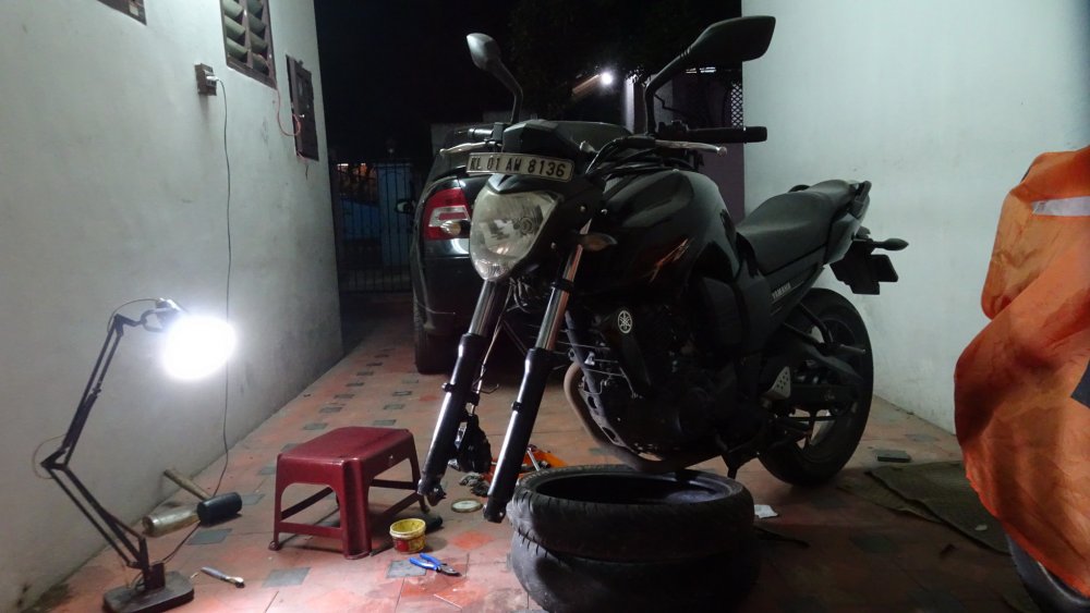

Fork Overhaul
One of the forks started leaking and decided to overhaul both sides completely.
Fork Oil Seal - 4EB-23145-01 - ₹ 250.00 x 2
Compared with old snaps and found GT had the same ones, exact same. RE packing ₹ 315.00 and hard to get.

Changed spring also this time.

Endurance Fork Oil - 350 ml - ₹ 100.00 x 3.
350 x 3. Needs 460 x 2.
Couldn't get Motul as there seems shortage of it and all were stocking KBX and Endurance.
Changed dust seal in one of the forks. Lost the snaps somewhere.
Fork Dust Seal - 4EB231440000 - ₹ 205.00
Snap Ring - 21CF31561000 - ₹ 7.00
Removed forks and got it changed at our regular Honda FNG, Vinayak Honda. Charged ₹ 450.00.
Total damage - ₹ 1672.00

Removing these 2 bolts after removing mudguard and brakes removes the fork without touching headlight and all.

Assembling back.
Done.

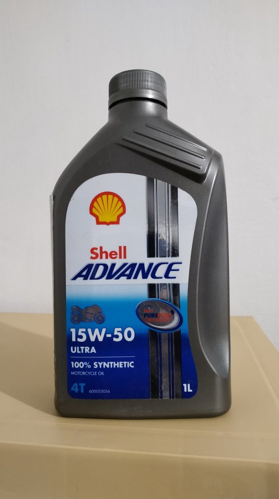

Shell Advance Ultra 15W50. Was already tempted to try out and it goes for 2/3rd the price in Flipkart. MRP ₹ 1051.00, got for ₹ 649.00.

Nothing comes free, obviously a bit old, but not enough to be concerned.

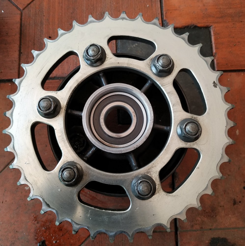

While washing, saw rear sprocket oil seal popping out. Despite multiple attempts, it wasn't fitting back properly. Removed wheel and checked and to my horror, the bearing was done. Don't remember replacing it. It was Sunday and no lathe was open to remove or buy new bearing. With tight schedules, taking off nor parking the bike was possible.
With many things running in mind, took a 1/2 inch socket and banged and the bearing popped out.
It was an NBC (Birla) make, model 6004 LH.

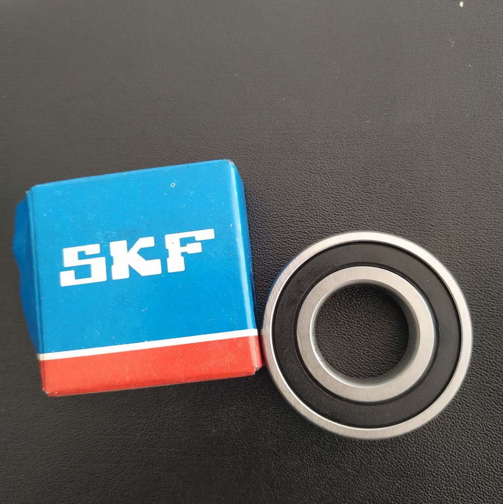

Rushed to the usual spare guy, who is open on Sundays. Voila and there was equivalent SKF bearing. Price was almost double the NBC make.
Model: SKF 6004-2RS1
Paid ₹ 230.00 (MRP₹ 239.00)

The bearing.
Cleaned and ready for install.
Place the bearing and gently tap it in. Use old bearing or a wooden block to spread the force. Don't hit on the inner ring as it can displace the balls/damage the bearing.
Used rubber mallet. Don't bang with your regular iron hammer.

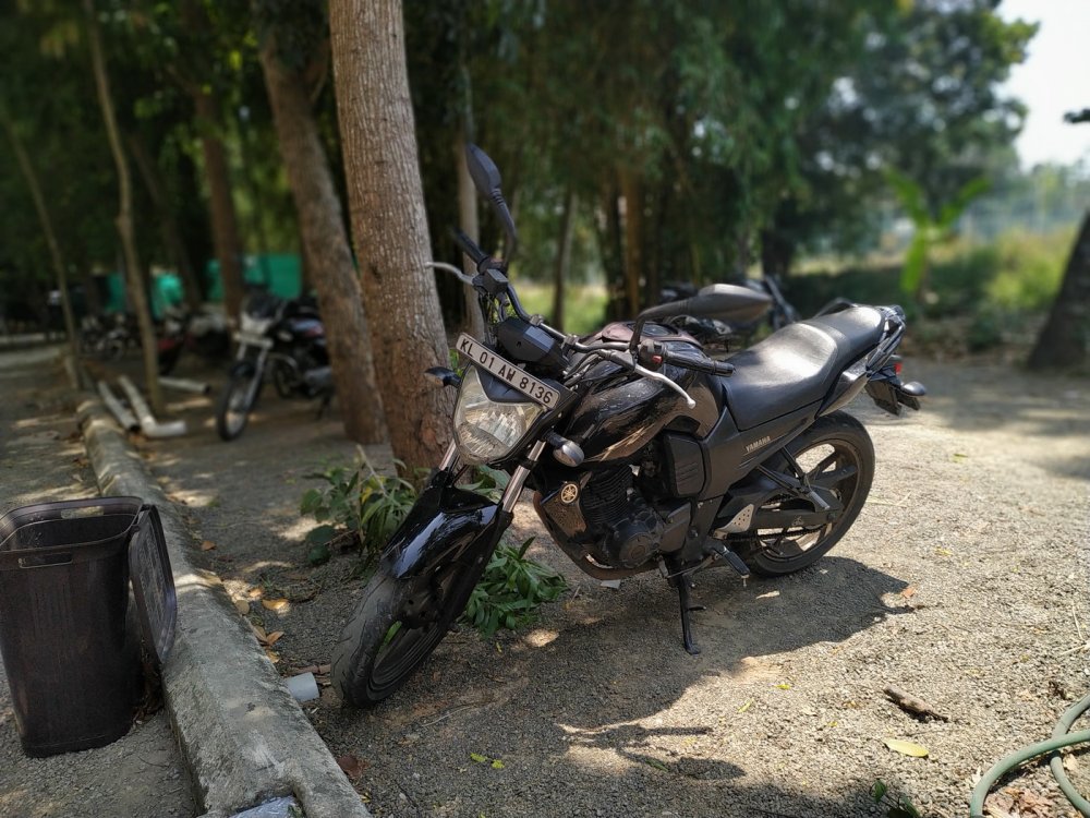

My Boy. (Ignore the waste bin [;)])

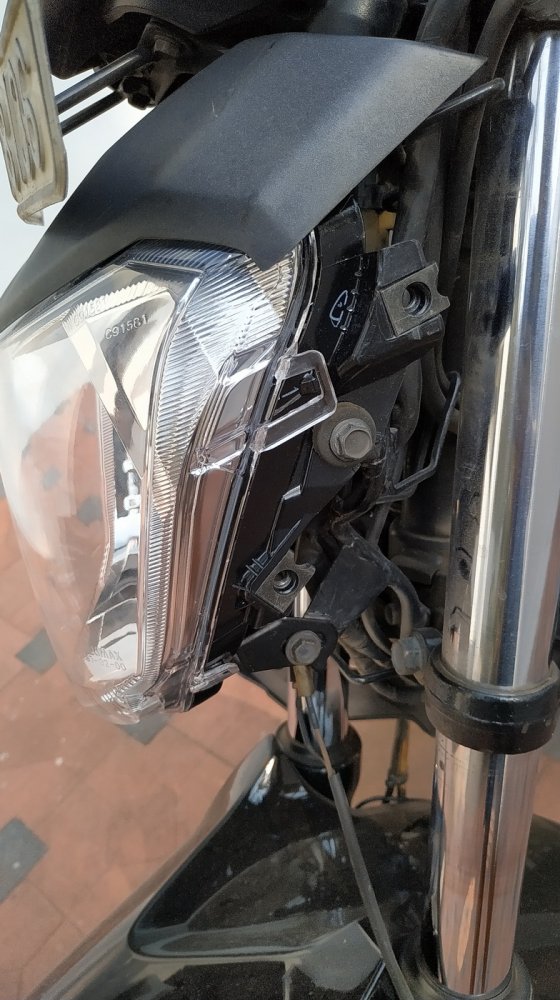

Replacement:
Old yellowish light.

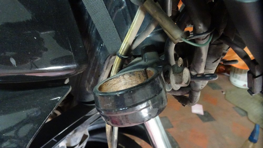

Undo 4 Allen bolts + 3 bolts, everything comes off. Disconnect lights also.
With upper cover.
2 nut springs and a rubber grommet with spacer in either side. Remove them as well.
Upper cover is fixed with 3 star screws.
All parts ready to be transferred to the new headlight assembly.
Upper Cover. Part Number 21C-F3121-00
Old vs. new.
All set.
Installed.
Beam adjustment. Highest position.
Lowest position.
Perfect
All set and one.
