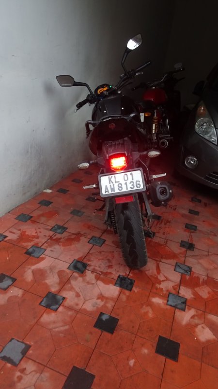

Random Click

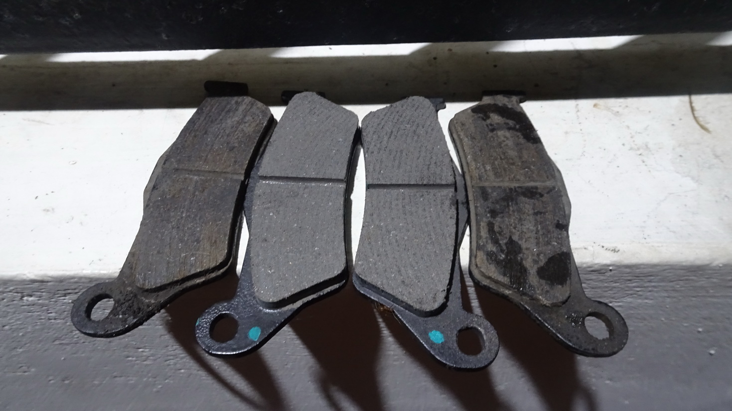

OEM Bybre Brake Pad Kit - 5USW004500 - ₹ 145.00
Disassembled, cleaned and greased.
Comparo
