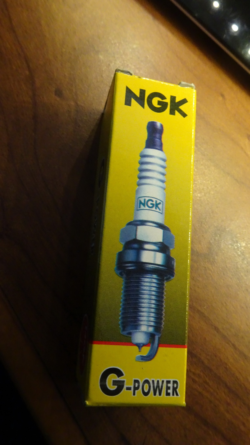

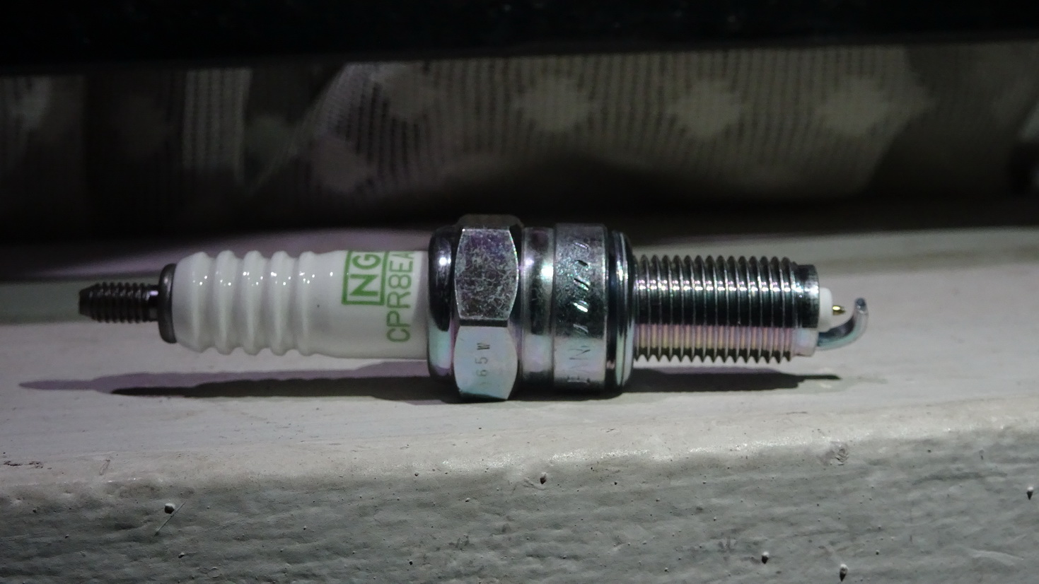

New plug. Again, NGK G-Power.
NGK G-Power CPR8EAGP-9 - ₹ 235.00
Old Plug
New Plug
