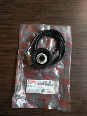

On the way back, speedo sensor went kaput and lost some 300 km of odo reading [frustration]
Bought new sensor. 670 bucks.
And an oil filter. 40 bucks.
New sensor.

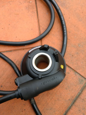

Made by Pricol. There are ones in Pricol packing that comes at 150 bucks, but never worked with FZ.
COmpared to old one. Too much play in old one, resulting in vague readings.

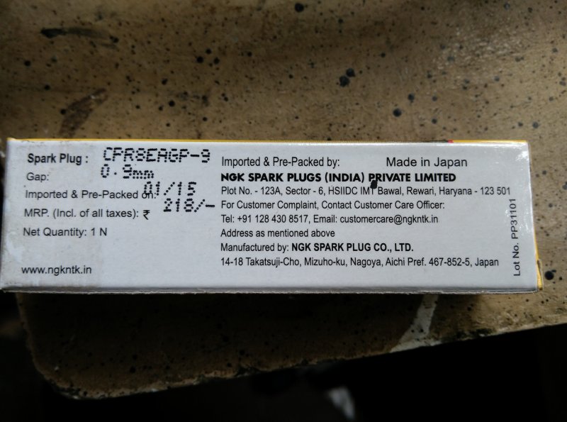

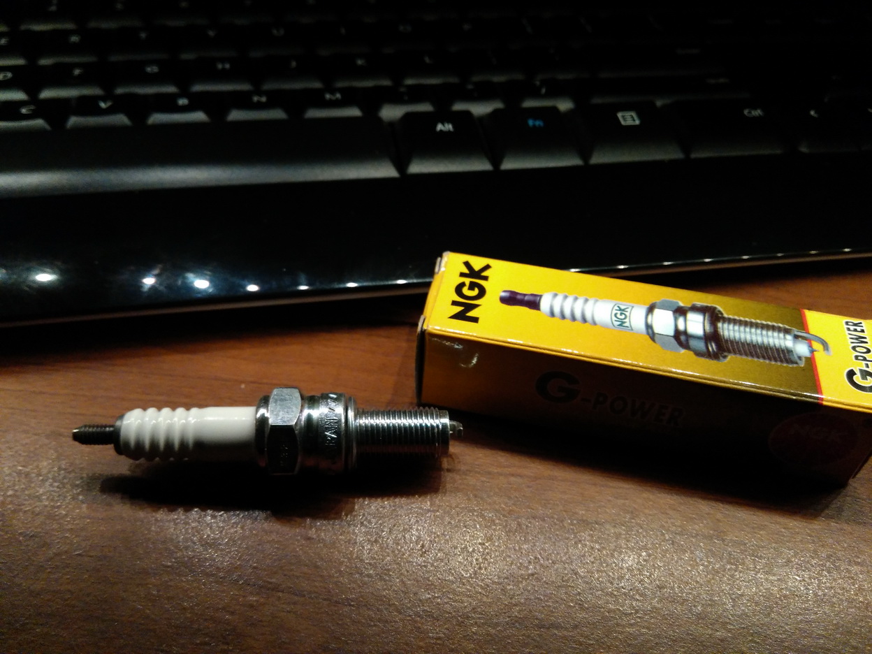

As usual, NGK G-Power CPR8EAGP-9
