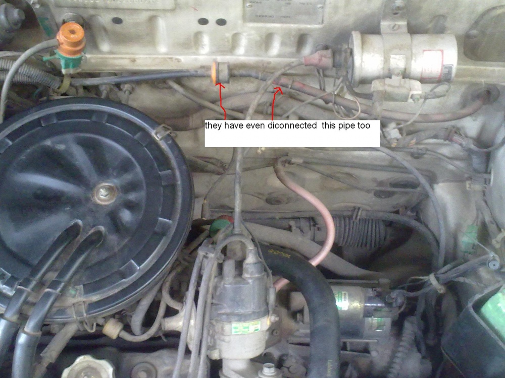

here are some pictures of the temperature sensor, thermostat valve of maruti 800 carb . also please tell about that box when i enquired the same he said there would be no use of that vapour filter

I think the one you mentioned in the second last photo is for managing electric waves or something
the pipes do you have AC fitted in this car ?

hyderabad
no ac not fitted, it says some gasoline vapour filter , mechanic says its of no use .if its of no use then why maruti installed it
