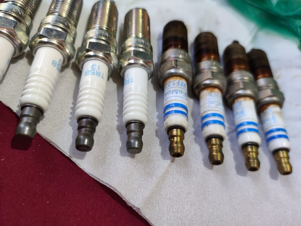

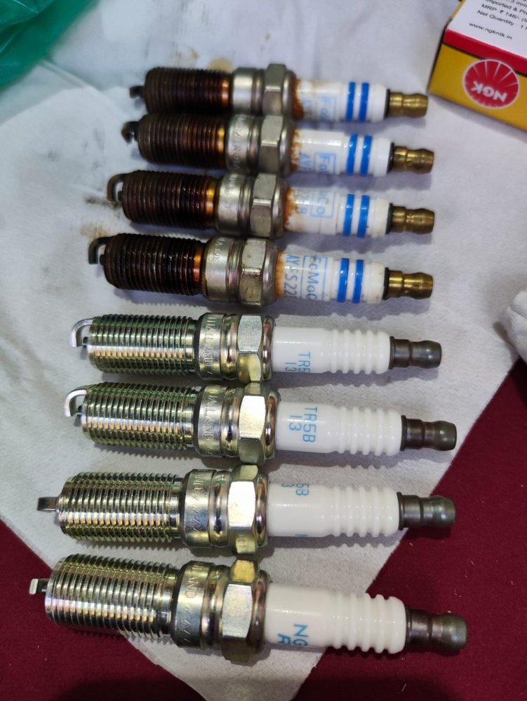

Old plug is oil stained and brownish.
Old and new comparison
Old are covered in oil/greasy substance

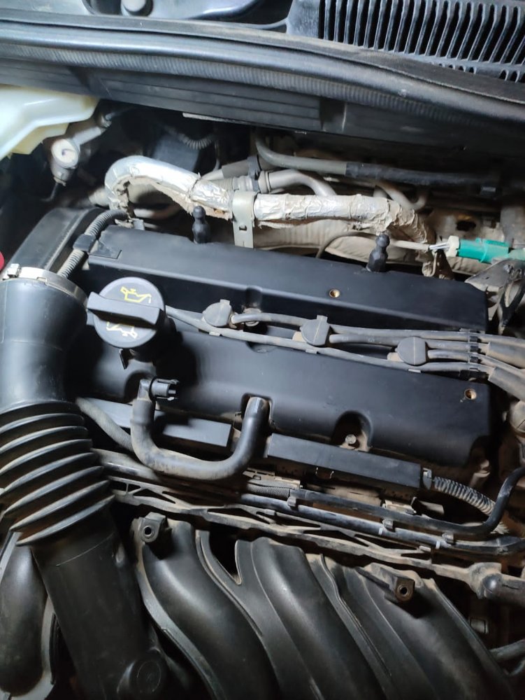

Before pulling up the spark plugs
Mud collected in spark plug intake plastic housing

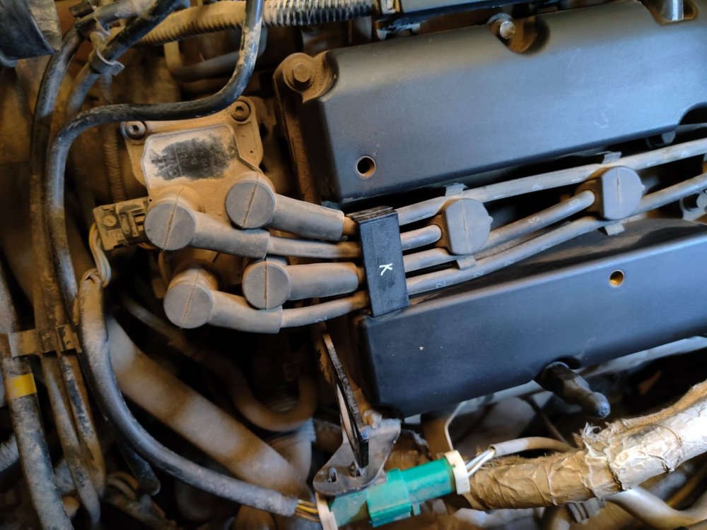

Ignition coils have a particular order. Cant be mixed or put wrongly.
I think the old plugs still has life left in them. What say?

Has anybody noticed, that Ford spark plugs have copper ends while "supposedly premium" NGK has aluminium ends.??
I don't know what to make out of all this. And how (if at all) it is going to make a difference in performance ??

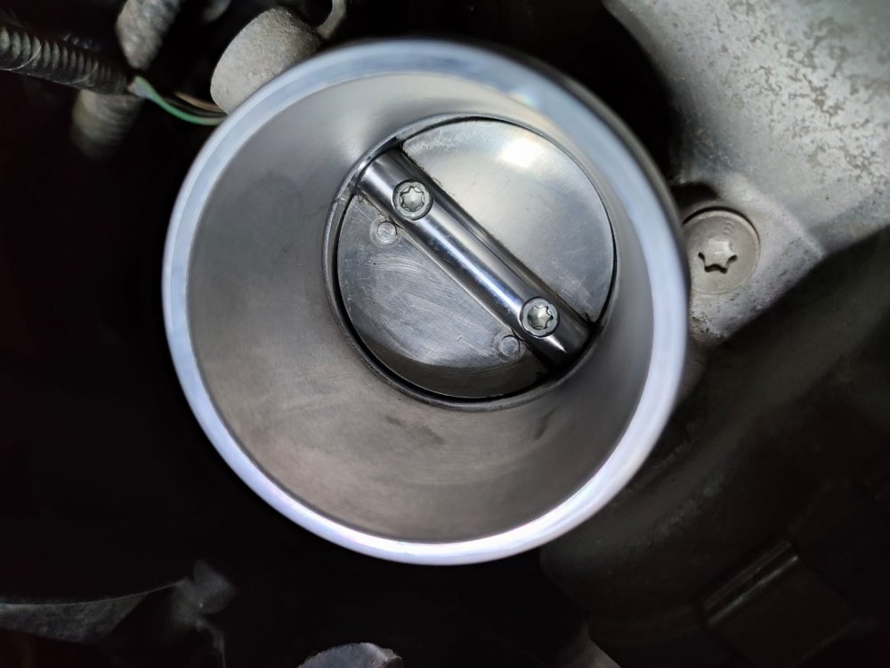

Throttle body was not very dirty, but was very sticky. Meaning that the valve was not moving freely. It was sticking at closed position because of gummy- grime like brownish substance. I cleaned that up with throttle body cleaner

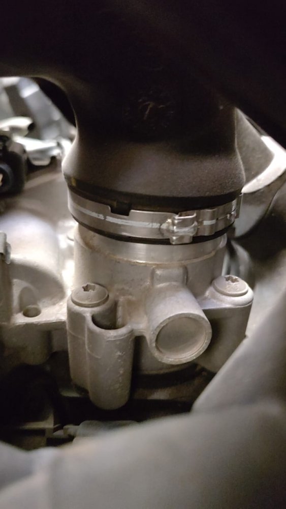

This one ear clip by Ford is easy to remove but very troublesome to put back upon
This one ear clip by Ford is very troublesome to put back upon. Lower clip is more difficult
This one ear clip by Ford is very troublesome to put back upon. Trick is to put it already before putting the pipe back

Dirty throttle plate
Air outlet from filter removed
Clean throttle plate

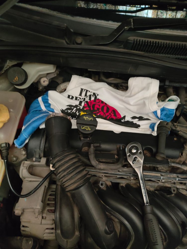

Always I stuff a cloth piece inside air intake. I don't want to get surprised by something falling into it or entering it
After putting every thing back together
So this DIY is now complete. I am satisfied to report that the irregular idling is gone. Now there is no irregular fluctuations in rpm at all.
Idling RPM is fixed at 900. Engine sounds very smooth , and well, petrol like. Compared to my Nexon engine NVH is miles ahead in my Figo.
More happy to confirm that my diagnosis was correct. Irregular idling was actually due to fouled Spark plugs and dirty throttle body.

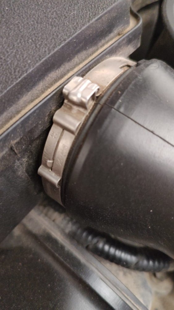

Ford has generously used One ear hose clamp also called Single ear stepless clamp all over the engine bay. Problem is that when you try to remove the hose it might come off easily but when you try to mount it back on the metal pipe, it becomes very difficult. There is no space for the hand or even fingers to put pressure for the mounting.
Try to put the clip before mounting the rubber pipe. It will go easily. Then mount the pipe with the clip.
If you try the clip after mounting the pipe the DIY becomes PITA (pain in the ... ). Hope it helps the DIYers.
One ear hose clamp
Above pics have been taken from the internet. credit : respective owners
Upper and the lower clamp on the air intake pipe
problematic clip
Put the clamp before mounting the pipe, and not after, as it becomes PITA (pain in the ...) then
