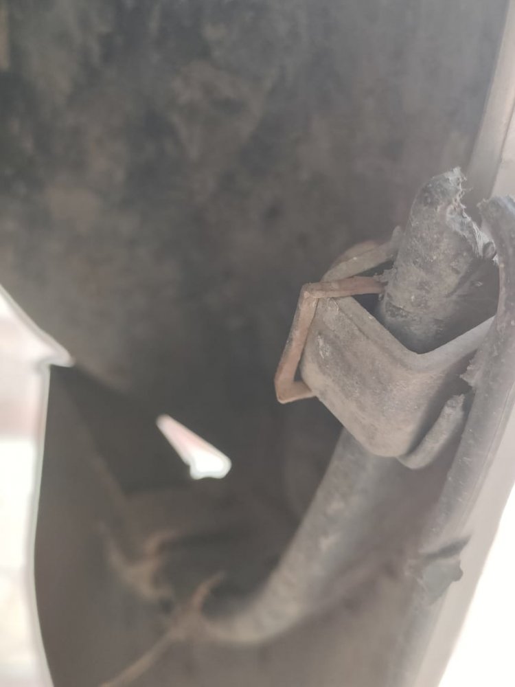

DIY Replacing broken Mud flaps of my Figo
This peculiar thing I have observed in all the Figos around me. All have 2 or more, broken mud flaps. Some have all of them broken. Mine has 3 broken. How did it happen ? Maybe its the speed breakers, or maybe the potholes. Don't know, but I have yet to see a Figo with all its mud flaps intact !!
I think OEM mud flaps were/are hard plastic. So they did not bend. They broke !! I was looking for Ford soft rubber mud flaps which will bend as they are flexible. But they are very costly. Ford introduces them in the 2nd version, as an improvement.
Old mud flaps
cracked plastic
Mud flap gone, only clips remain !!!
this side broken too
1 Intact mud flap
All cracked, about to fall down
existing clips are badly rusted

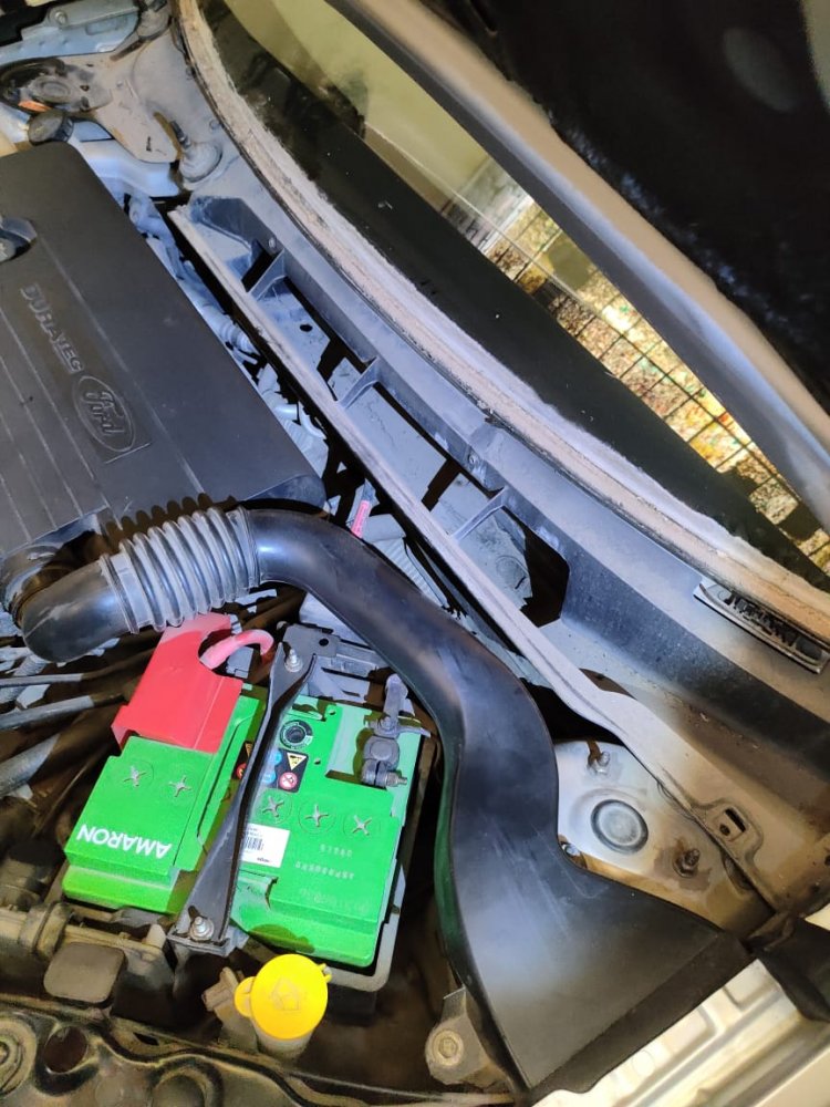

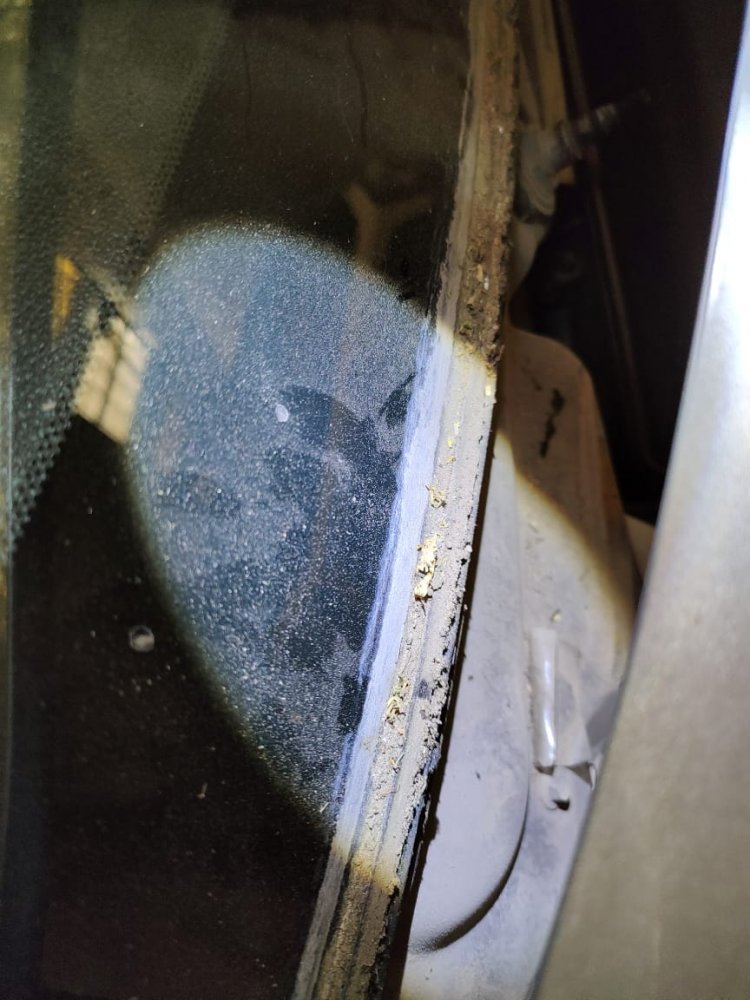

DIY Opening up the cowl area in Figo to inspect and clean thoroughly
Water seepage issue in the passenger compartment. Whenever someone washes the car or there is rain, water enters the driver and passengers footwell. And it gets filled up fast.
The solution I have found out was lots of dirt and leaves collected in the cowl area, blocking the rain gutter. As a result water was entering from the fresh air vent, inside the passenger footwell. I don't know for how long the leaves were collected, as most had shrivelled and it became more like muddy substance with intermixed rotten leaves etc.
Here are the pics:
first remove the wiper stalk. Looks easier but actually this is the difficult part. Bolts were jammed. Fear of breakage on excessive force loomed large.
Cowl opened
After removing dust

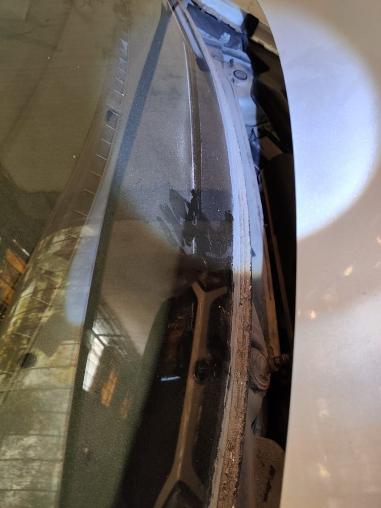

This grime on the edge of glass was preventing water drainage
water drain totally blocked
this side drain is partially open still
Hole at the bottom for drainage
water channel is just behind air intake pipe
Hand was not able to reach inside these small multiple alleyways. Look at the grime on the bottom edge of glass
remaining pics:

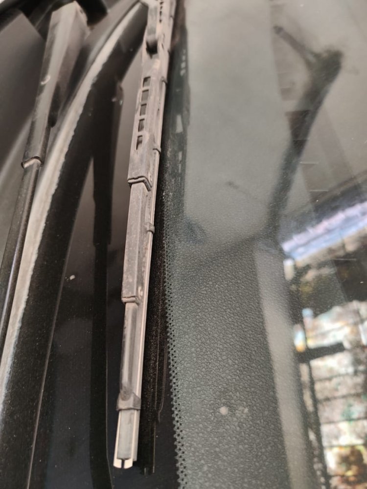

Always make a mark with chalk or crayon for the wipers, will be helpful in installing it back
Marked the wiper point at E8
water plaque marks at the windshield bottom
Note water plaque marks at the windshield bottom
Lots of mud deposits below cowl plastic
Finally cleaned and all installed back

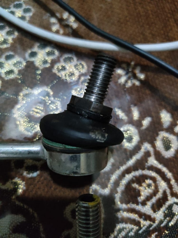

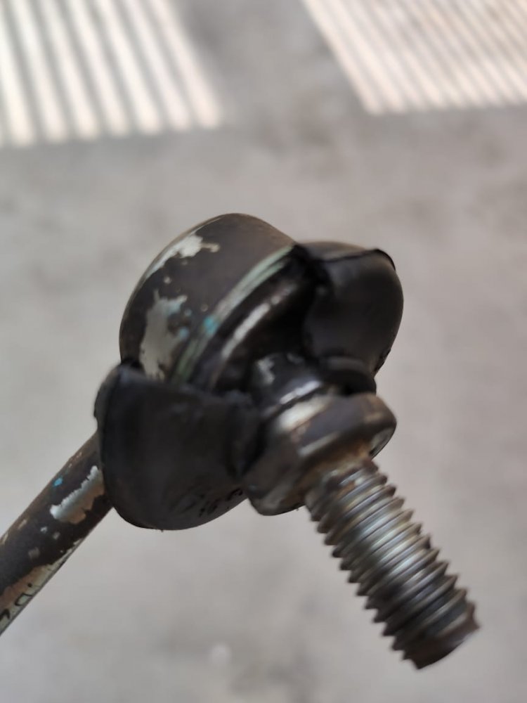

DIY changing Stabilizer links ( link rods) on my Ford Figo.
On examining link rods closely, found the rubber bushes damaged and the grease long gone. Changed the rods after procuring them from the market. Genuine Ford Figo ones are rare to find. It's always Rane or Euromac available in the shops. After some effort got the genuine Ford ones.
I am not sure that after market ones are good or bad, but in the market they are 1/3 the price of genuine ones. So yes a lot of money can be saved by that choice. But I was not confident so went ahead with Ford ones.
Caution: Lift the tri link/suspension little bit with a 2nd jack to fit the link rods in the allotted holes. Otherwise it will be very time consuming process.
Pictures:
Old ones
Rubber boot is cut, and no more any grease left
Here the rubber has become loose, and water goes inside while washing etc.
