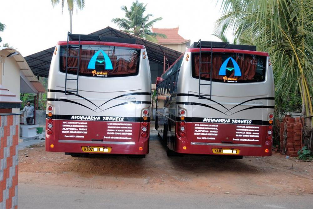

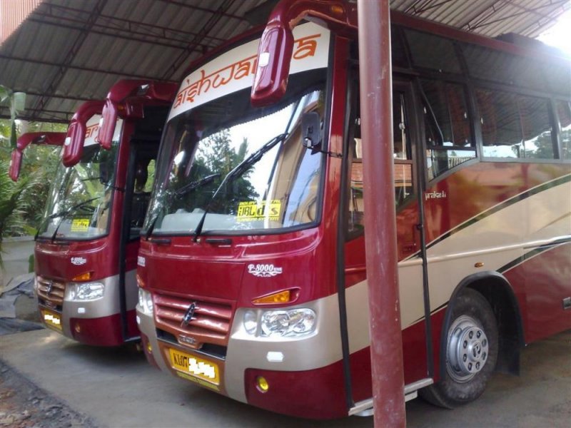

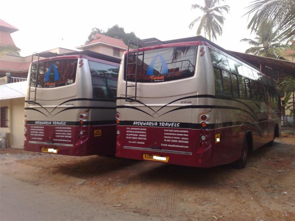

Finally the pics of the buses-

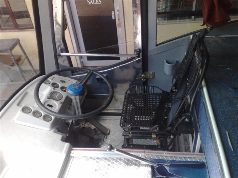

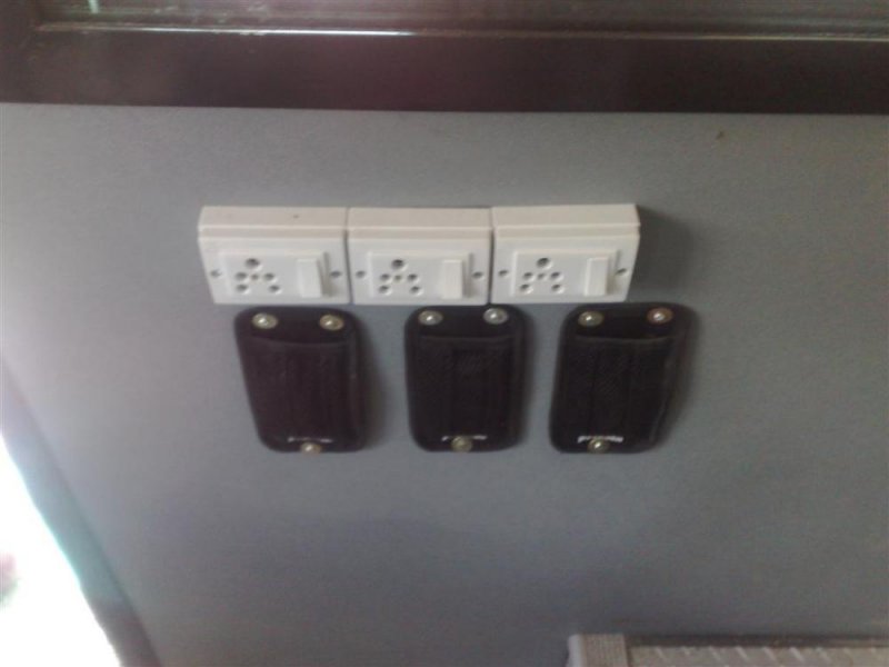

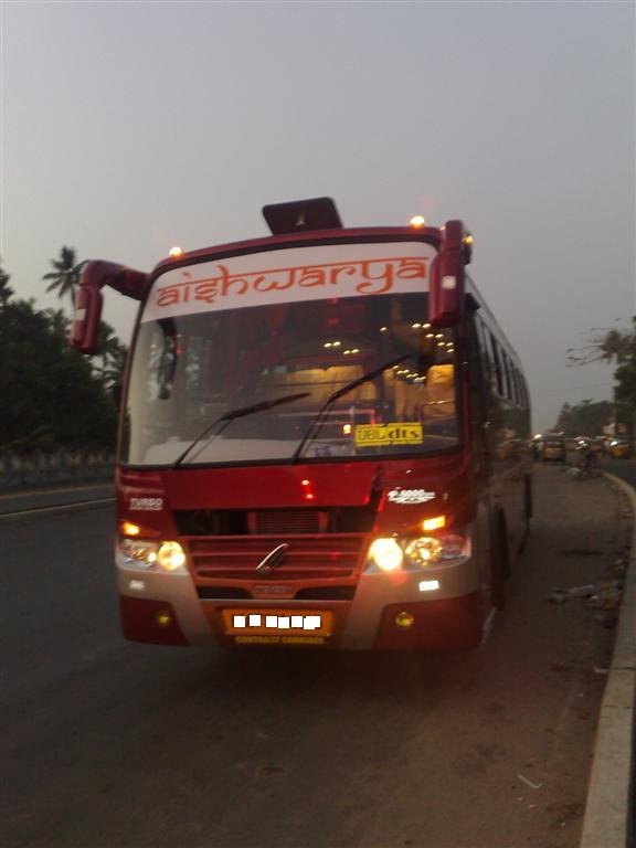

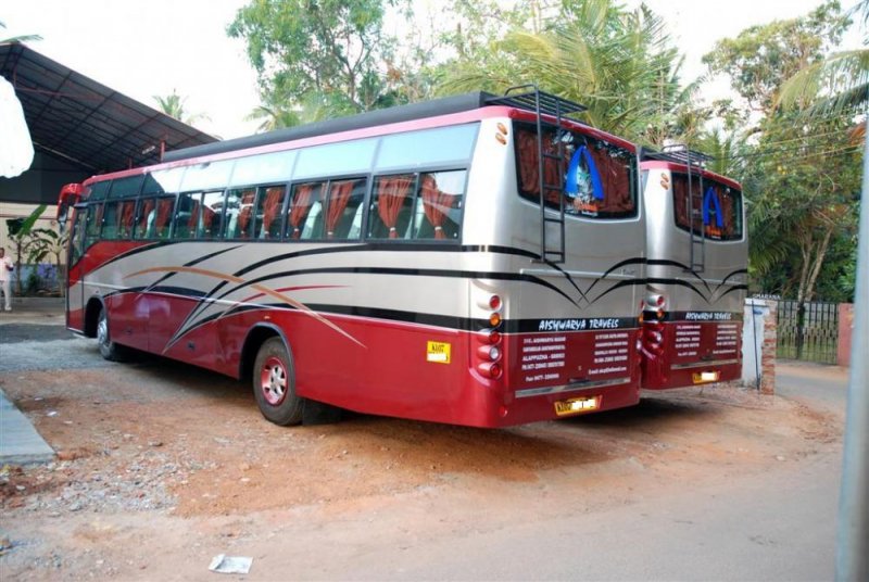

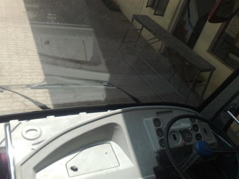

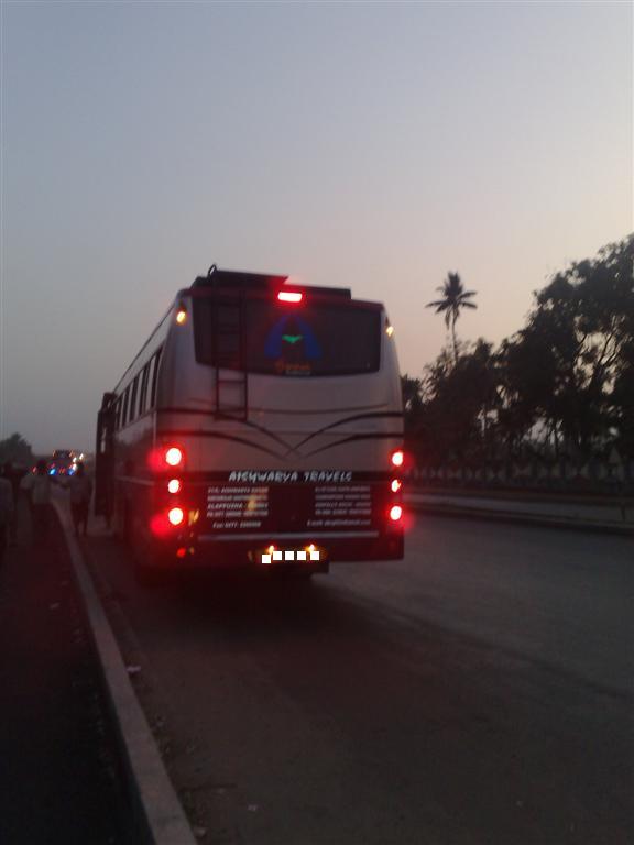

some more pics-
Some more info on the buses-
1) the instrument console has a speedometer, an ammeter, two air pressure gauges & a fuel meter. warning lights consists of the turn indicator signals & high beam signal. there is also one red light which glows slightly when you lift of the throttle & goes away as you rev the bus.
2) it no longer has the push button type starter. you twist the key to start the bus like in any car!
3) the air pressure gauges shows the air pressure in both the air tanks for front & rear air brakes respectively. it reads from 0 to 10. for the brakes to apply, the pressure must be above 6 atleast. when the bus has been lying idle for long, the pressure drops to below 2 & the bus has to be revved to fill air in both the tanks. this is a 5 min procedure every morning! AL has provided a warning buzzer as a safety feature & it remains on till the needle goes above 6psi. it also remains on if the handbrake is engaged. another important thing to note is that one should not pump the brakes in a stationary bus, the air pressure will fall.
4) the steering wheel is aligned a bit to the left with the seat. the power steering is very light & the bus can be steered easily.
5) the seat has seat height/tilt adjust & slides on rails too. the seats have seatbelts too.
6) gear shifts are a bit hard & take time getting used to. the bus has a 5 speed synchromesh gearbox. the first gear is called as load gear & is used only with full load on steep inclines otherwise the second gear is used to start the vehicle.

Wow Raj!
Buses looks awesome!
Nice choice of exterior & interiors colors.
JBL audio system is iceing on cake!!
