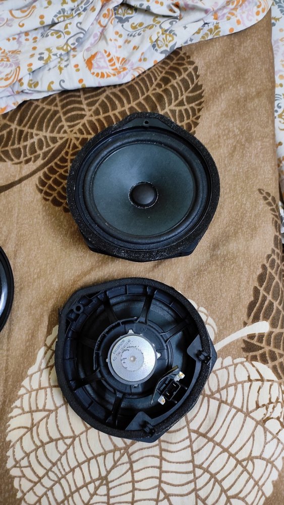

Maruti OE vs Honda OE

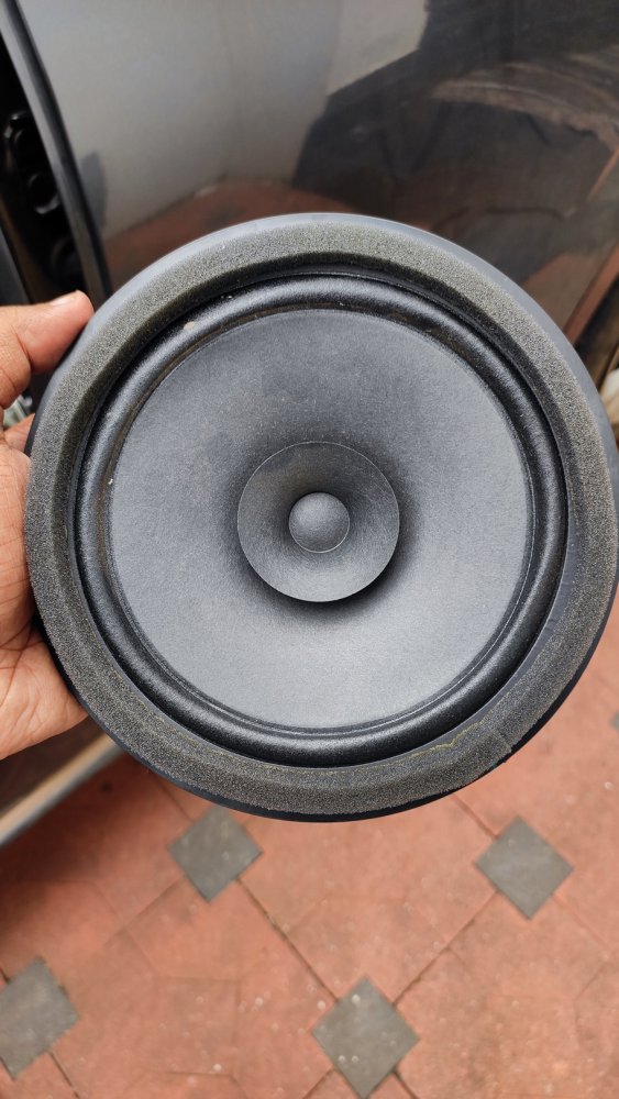

Maruti speaker - 39102M62S00 - ₹375/piece

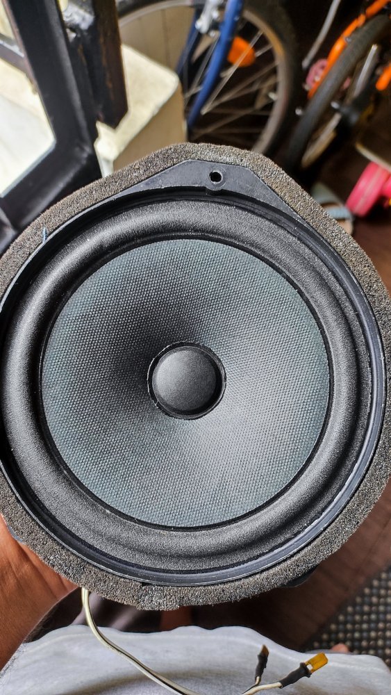

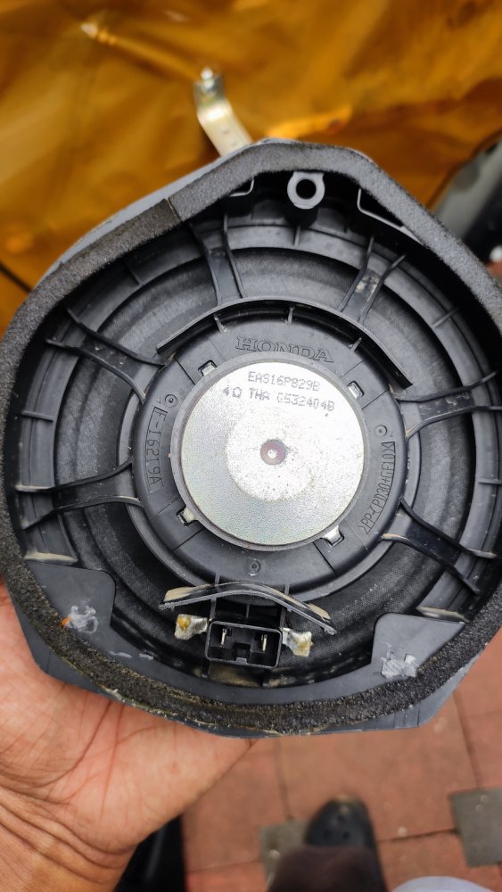

Honda - EAS16P829B
Came in Honda City 2017 model. Both of them 4 ohms. Cut off the tabs for Honda doors.

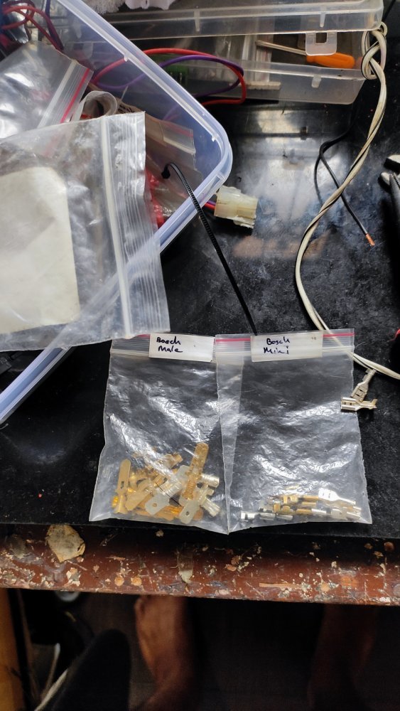

Connectors from bin and the custom plug-N-play connector.

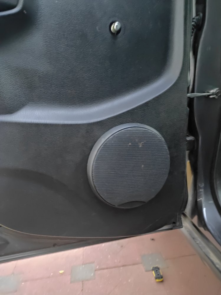

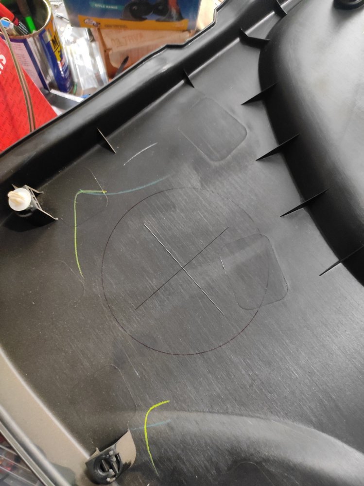

Simplest grill from the bin. Couldn't get hold of the original S-Presso grille yet (even now). MGP outlets are suggesting ordering at the time of service from service center.
Marked.
Cut.
Grille installed. Will replace with OE grille some day.

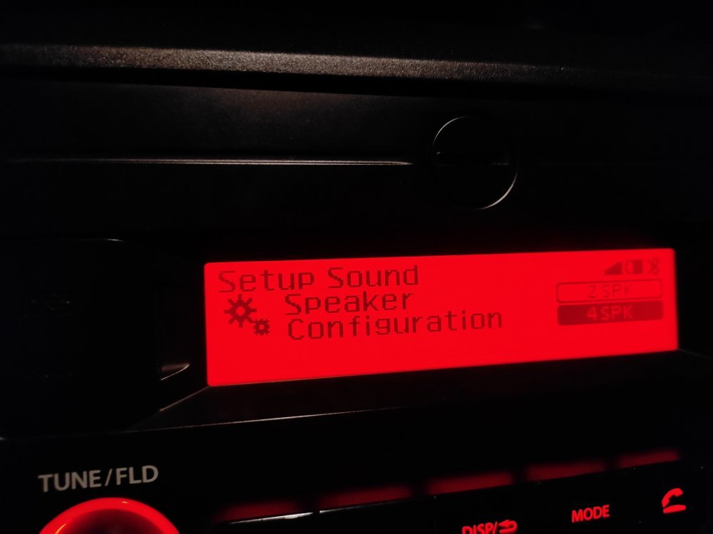

Last thing is to enable rear speaker in HU.
Overall setup is great now.

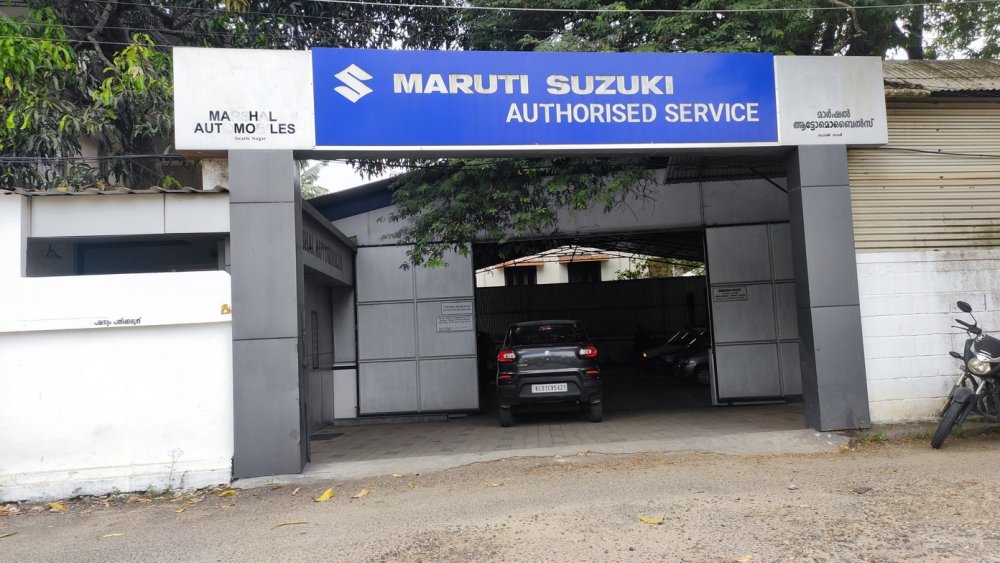

Service Time. Done at Marshal Automobiles. First paid service.

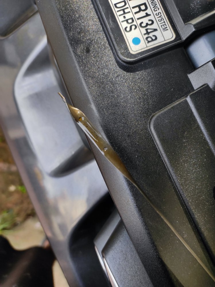

Parts:
Ecstar NEXA 0W16 Engine Oil - Shell - 99999MN0W16-SHL - x 2.8 L - ₹ 1,260.00
Oil Filter Assembly - 16510M65L10 - ₹ 94.00
Non-Amine Coolant (SG) - 99000M24120-551 - ₹ 280.00
Brake Fluid GC1500AA (250 ml) (DOT3) - 99000M24120-580 - ₹ 190.00 (Confirmed DOT4)
Screen Wash - 990J0M999H2-260 - ₹ 17.00
Caliper Shim - ₹ 80.00
Wheel Tag x 4 - ₹ 20.00
Consumables - ₹ 75.00
Labour:
PMS-20K - ₹ 1,581.20
Front Brake Caliper Repair - ₹ 571.12
Manual Wheel Alignment - ₹ 200.00
Total - ₹ 4368.00

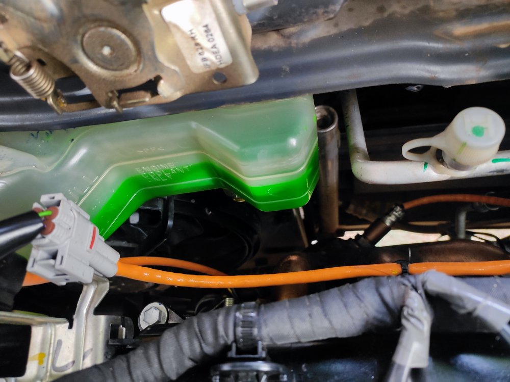

They replaced the golden yellow coolant with the green one.
I checked the manual and compared both the bottle labels side by side; even the fine print was the same except for the part number and the label colour.
