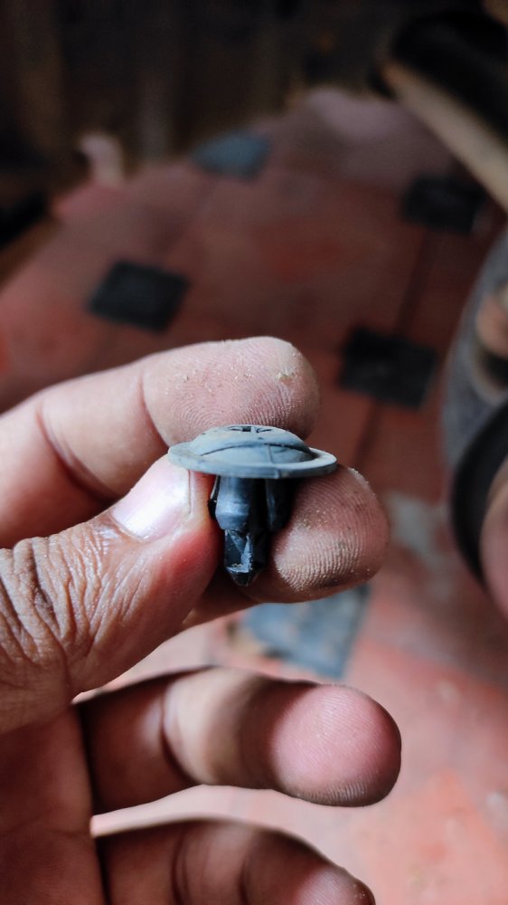

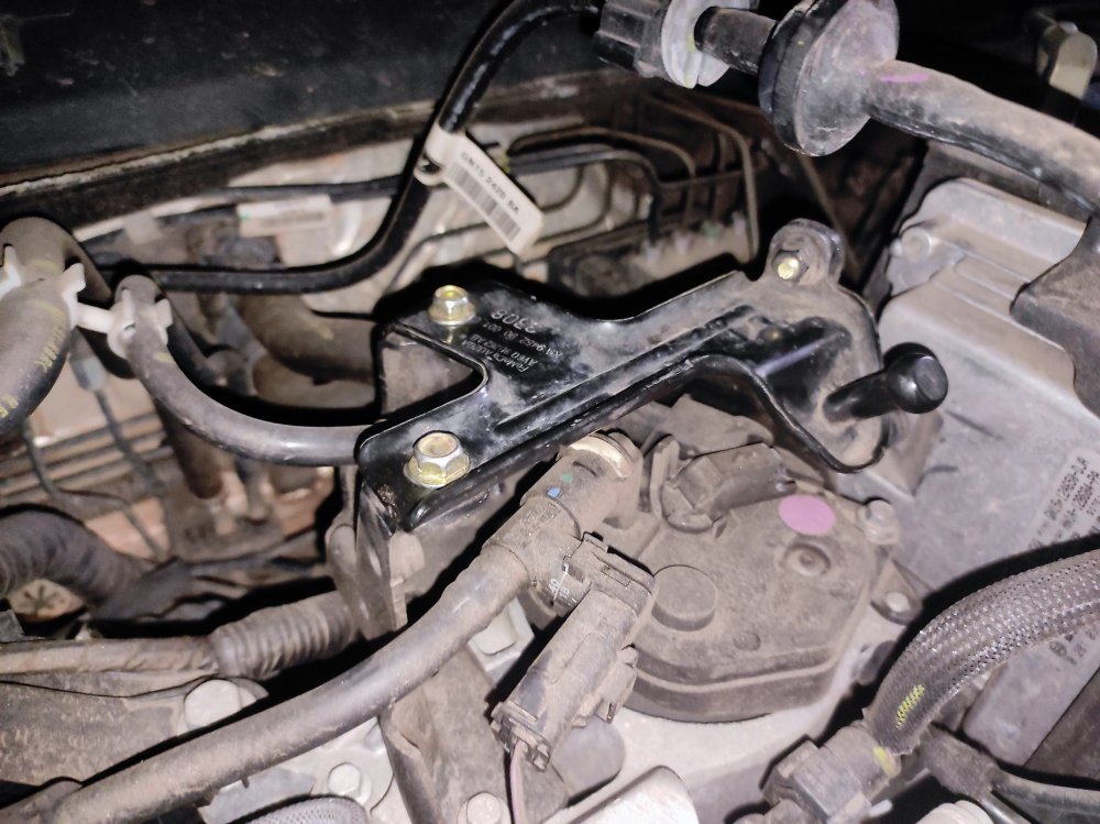

Heard a rattling sound when I started the car and it remained in idling, but disappeared on throttling. Thought it would be some engine trouble and umpteen negative thoughts scrolled through my mind. Popped the hood and found a clamp stuck on the side of the engine.
Took it out.
Clamp for mounting engine cover. Indian version never got the engine cover, but Ford retained the clamp. Global Fiesta had the cover and seen some swaps.

It sat over the fuel filter. Replaced the fuel filter last service and the morons did the magic. Either didn't install the bolts or didn't tighten it or, worse case, might have dropped the clamp and forgot about it.

Fresh stock of flange nuts and bolts bought recently.
Needed three 10-mm bolts, means three were missing. Even a properly tightened single bolt would have retained the clamp in position.

Coming back to the clamp, sanded it out and painted.
Installed back with an Amazon cover in between to prevent future current leaks. Paint started peeling at other places. Would paint it completely the next time.

Spotted one of the wheel nuts was deformed, just Ford thing. Took some effort to remove it. OE wrench would slip.
Deformed one vs undamaged one. Installed the damaged one in spare wheel with plan to replace at next service.
The infamous two-piece Ford lug nut.
