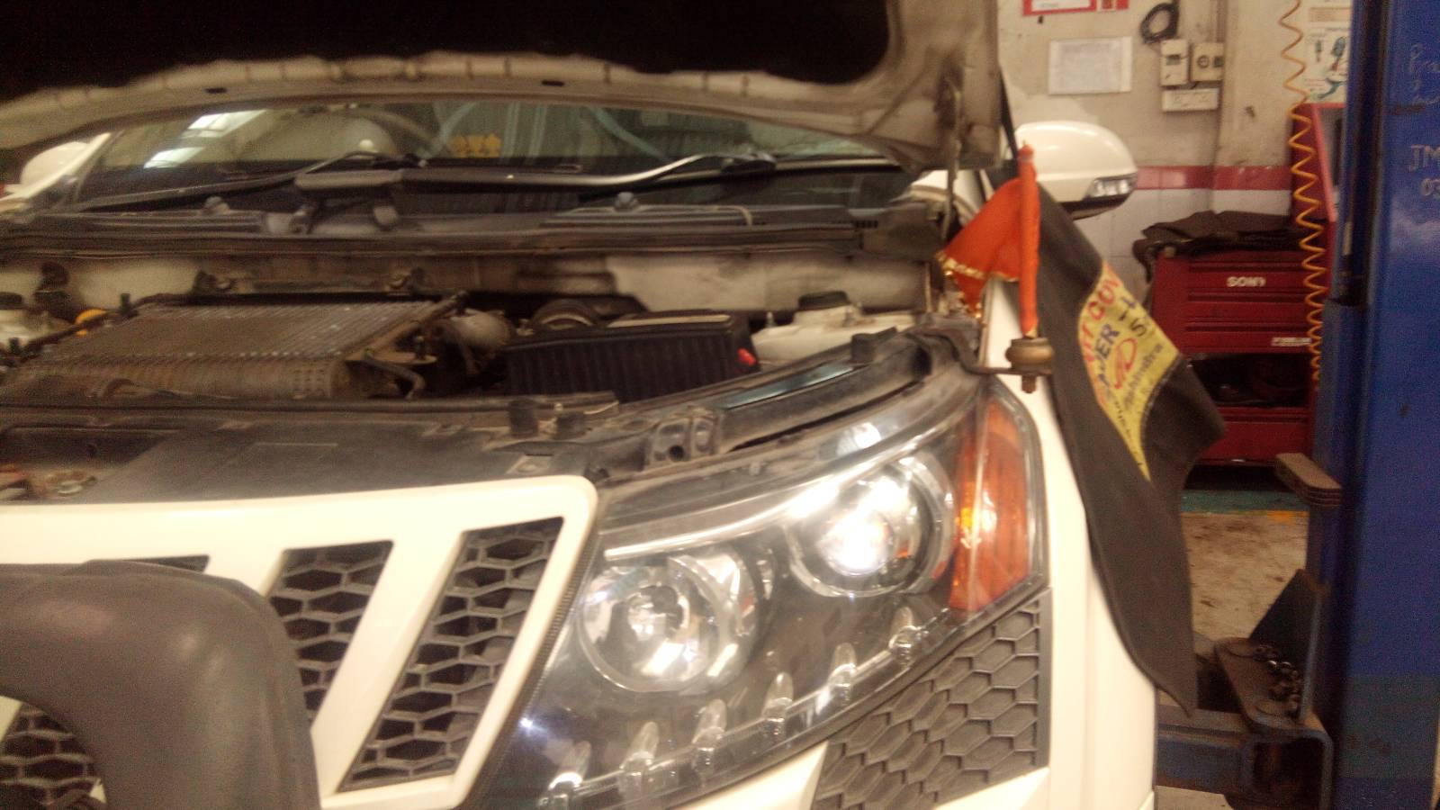

Thunderbolt XUV 70k Service-
The beast was running fine and all was well.
As per the recommended Interval I took the beast to Nashik for 70k Service. The round trip was 350Kms for the same.
We reached at Jitendra motors at 10 in the morning. Our usual SA, Amol welcomed us with a smile. There was quite a bit of rush so vehicle was taken in only at 11. The SA sent vehicle for wash as washing bay was free and mechanics were not. This time I must say, their washing was very good. The beast was gleaming like anything. They also applied tyre polish. Glasses were clean. Interiors were cleaned with compressed air and cloth.
There were'nt much issues to report. A few highlights-
1>TMPS showing tyre swapped (I havent swapped any tyres though)- TPMS learning done.
2> Tyre pressure low in Spare wheel- All wheels tyre pressure filled and correctly set
3> Air filter cleaning- Done
4> New AC Cabin filter installed as per schedule
5> Signs of rat entry in Cabin!. After looking high and low, could not find any entry points for rat. The air intakes are already meshed. Experts, advise.
6> Top up done for coolant, Brake oil (very minor qualtity Both). Washer fluid filled.
7> All Lights checked. Told them specifically to NOT touch HID systems.
8> No updates for ECU or Maps GPS available. SA hinted that there may not be anymore updates for 1st gen XUV as 2nd gen is already here and uses different file formats.
9> Tyre rotation done.
10> Driver side brake sensor wire was cut. Joined and taped it as connector was not available.
11>Overall service cost, 3500. Fuel Filled.. 3000.
12> Achieved 77,777 Milestone. Stopped and took Pic.
13> Vehicle was washed and cleaned once again before handing over.
Found one XUV with 265/65/R17 Ceat CZAR AT tyres installled. Looks very nice and butch. But hardly any space in wheel wells remain.

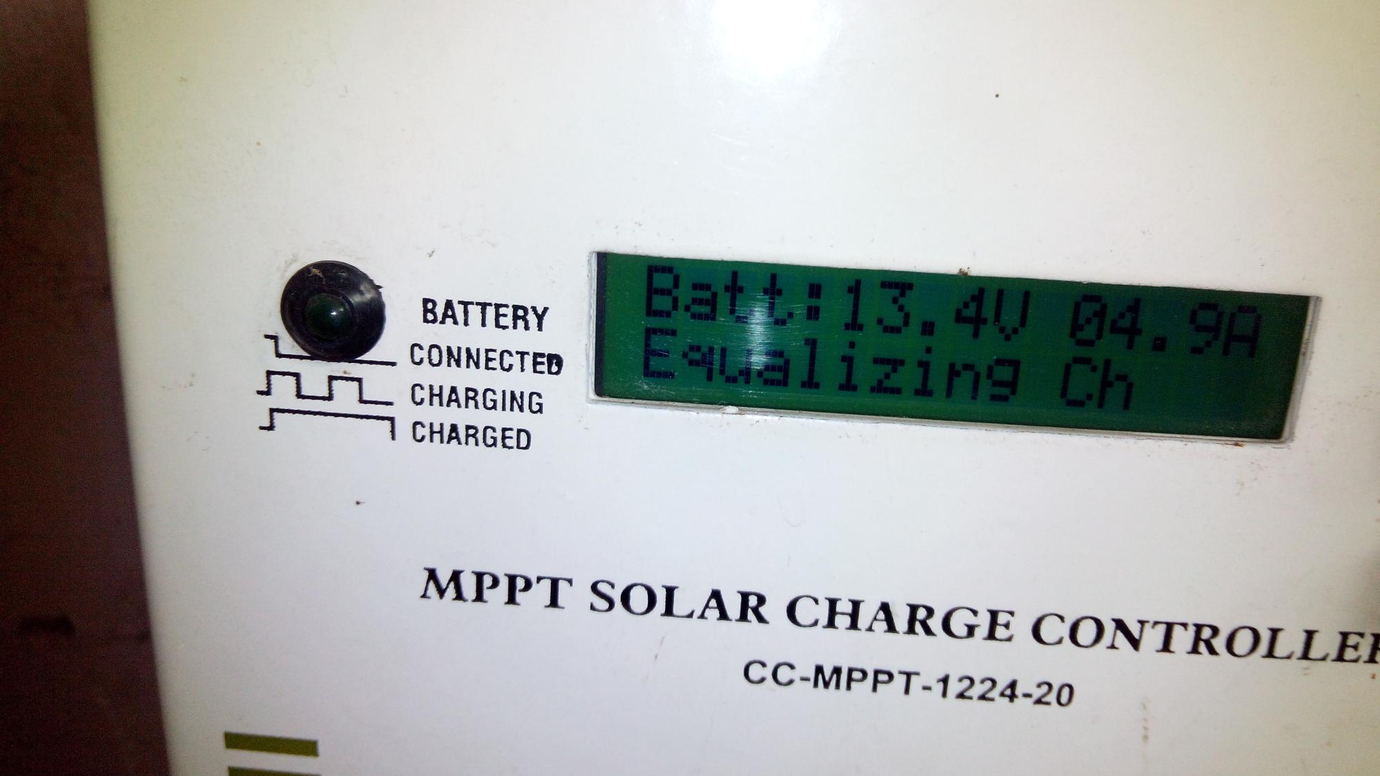

So as Yesterday I tried starting the beast exactly after 1 Month of rest. And Unsurprisingly it failed to start. Only relays would click and dials would restart.
So removed battery and put it on charging on my Solar system. This time after charging the battery to around 13.8v, I have a further boost charge till 14.7v. It helps dissolve sulphation and also restores battery health. Electrolyte was already level. OCV was a dull 12.42v
Charged in the Noon. Set it to rest.
After overnight rest, the battery reported OCV of 12.81v. That assured me that battery was good and there are no shorts/open cells. Installed battery in morning and cheetah roared to life in a go.
P.s- I notice that Mahindra has given Start-stop certified battery. Nice.

It seems battery charging has worked its magic and there were no starting issues all throught the trip.
