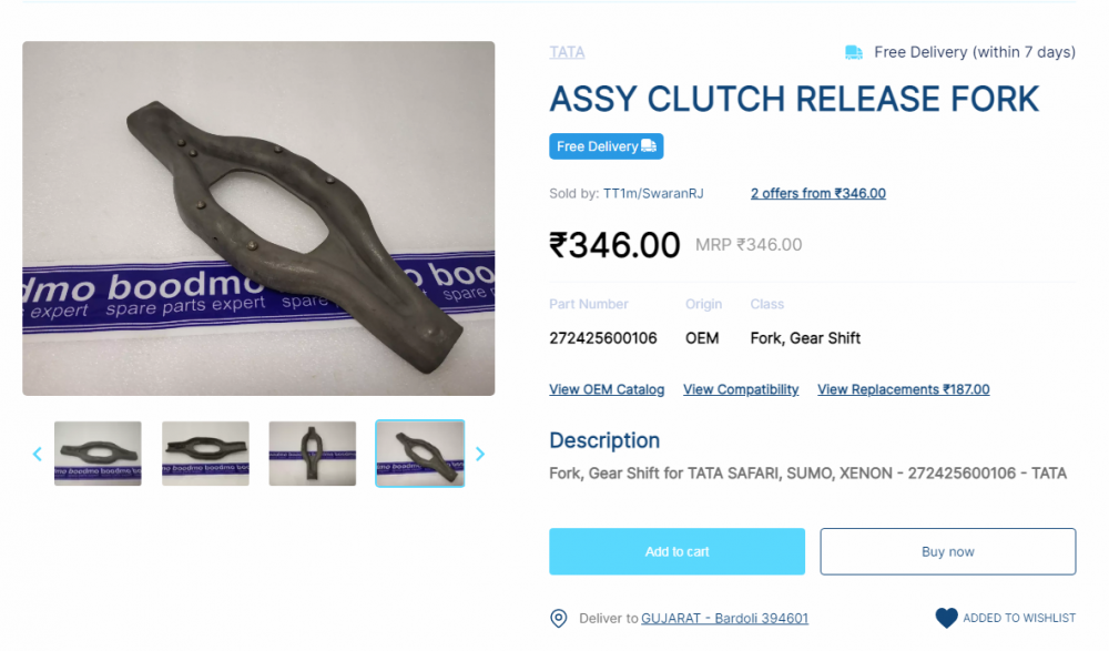

The above image is a clutch fork. The hollow area in the middle houses the drive shaft & clutch bearing.
This fork lifts the clutch when pedal is pressed.
This zoomed in area has a divot where the slave cylinder applies force. As you can see in earlier images, the divot area has been drilled through by the slave cylinder shaft.
