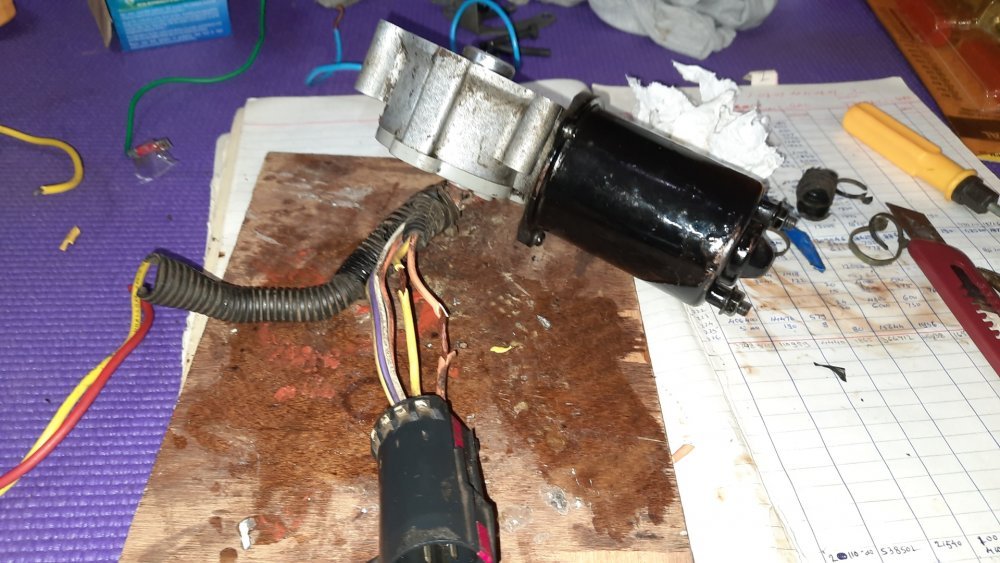

Once in a while, The 4x4 system on the Safari Throws a tantrum and asks for some TLC.
Here is a short post regarding the yearly Maintainance on 4x4 motor. Not very detailed as i already have a full guide here-
Borg Warner Electric-Shift 4x4 Troubleshooting & Repair
So here we go-
Firstly, The motor was removed from under the car. Its quite some workout without having a proper lift. As This motor sits behind the transfercase, In absolute middle of the SUV.
Nice to see my last years markings still visible,
The motor was throughly cleaned using diesel,
Any visible surface rust was addressed using a few blasts of clear coat,
Stops the rust from spreading sans the mess.
I forgot taking the pics of inside the motor, since I was focusing on the Job and hand. Here are the pics from last service-
Everything was cleaned and Re-Greased.
Coming back to today, You notice I've made some splices on the wires.
And soldered 2 new wires on top of Main Motor wires. Solder provides the perfect joint.
Other end of these wires go an XT90 connector. I already have the female end of XT90 at the vehicle side, routed to inside the cabin. Any guess of this secret project?
Fully taped up, The motor ready for install.
Yay! 4x4 works as intended.
