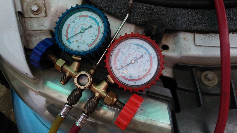

With that done & Said, It was time to move on to Another major issue, the AC leaks.
So I approached a nearby FNG to get it done.
The Roof Cooling was diagnosed as leaking. They carefully checked the leaks elsewhere but Roof looks like it.
Thankfully, A Used Roof AC unit was available from Salvage Safari, So the mechanic brought one in. Transferred the Said coil into my Roof housing.
Time to check leaks again & fill gas.
Finally after a year or so, I have fully working Safari!
