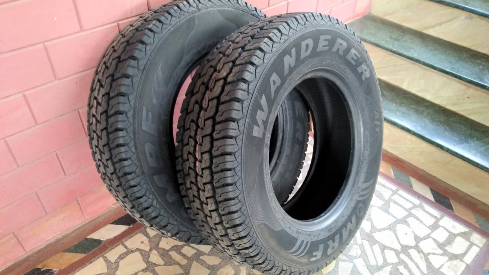

Brought New Tyres for the Beast. MRF Wanderers AT at 6.7k a piece (With bill)
Have a look at MRF wanderers AT. They are good and economical too.
NO need to waste unnecessary money on fancy wheels .You have to use it roughly. They will do. I would have done exactly that. Rest is up-to you.
Happy for your new tyres. Looking badass !
I already advised you so. Few years back.
Yes. The beast Has hardly seen any use since 2019 and more so following lockdowns.
