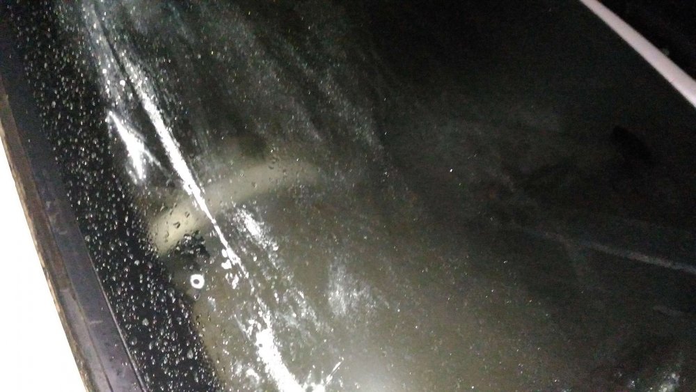

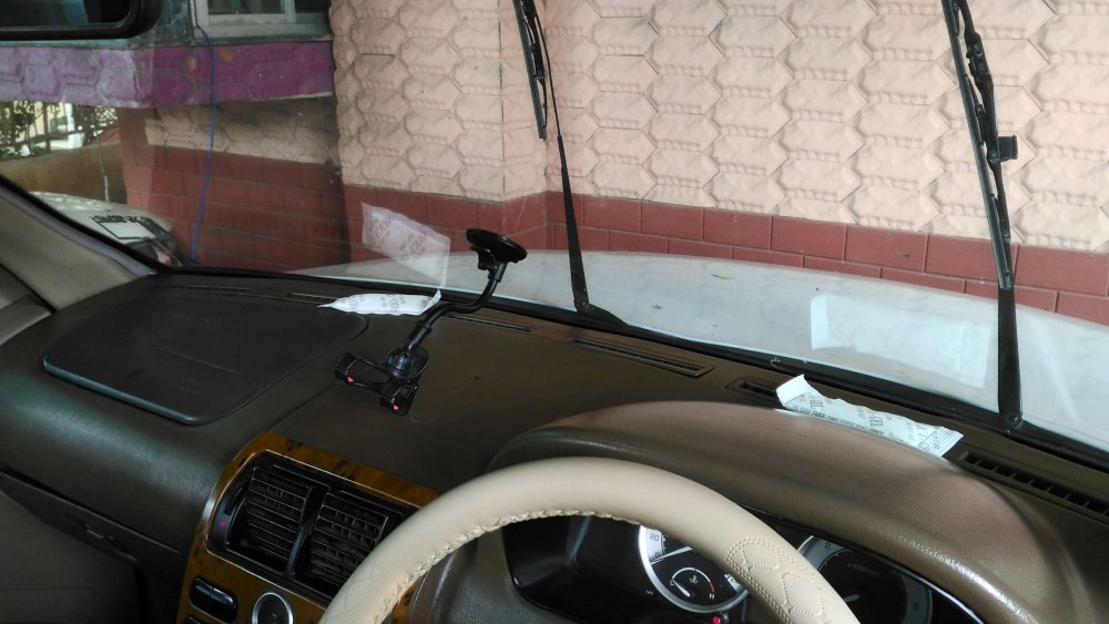

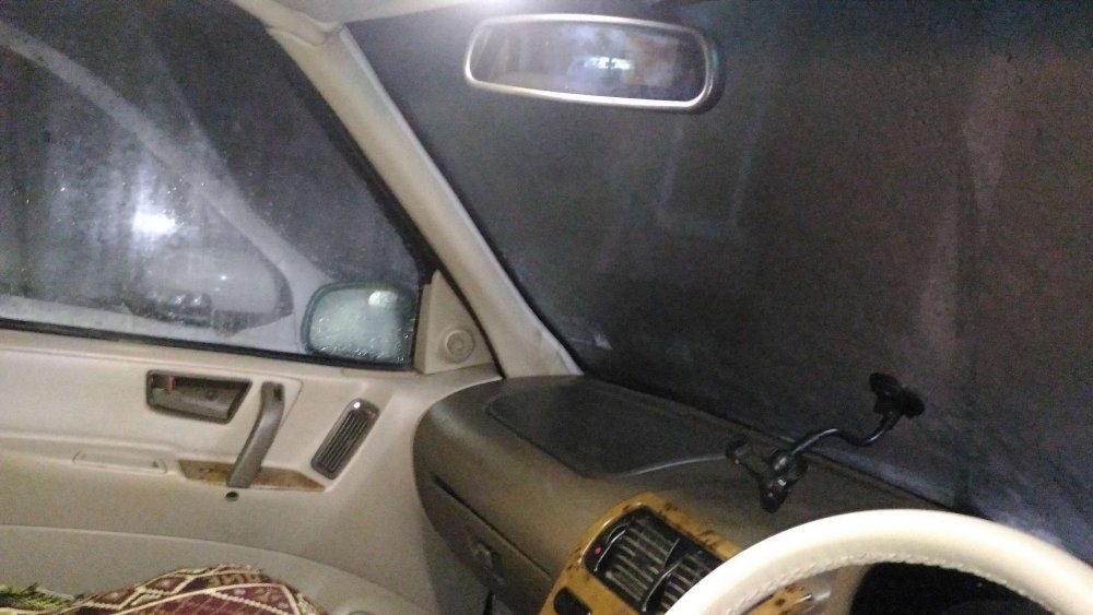

The elephant has been suffering major issues with Moisture & Fog. Each and every glass is fogged up. Carpets have become damp. Just placed some silica gel hoping to get some relief.

Why don't you open and air out the interiors ..there is a risk of mould formation and smelly interiors with prolonged dampness..check your door seal rubber and floor rubber grommets for degradation..if possible place a room heater inside and dry out

After placing the silica Gel overnight, The fogging is gone.
This is a very good idea. However I do not have a room heater, And I did not want the risks of placing one in such a small space. So I used the British era technique that works lovingly.
You closed every exit with those damping pads(including AC air inlet points i guess) - so this is but of course expected.
Remove those first thing! Else you are risking a major fungus spread inside.
I do agree with this that so thorough air-tight type of sealing should not be done.
Ventilation is a must part engineered into the design of the vehicle.Sealing everything is unhealthy as well as staleness-promotional. Rusting is also speeded up .
The issue is happening due to Trademark Safari "Wetting the carpet" syndrome. Its a hereditary issue and comes with Most tatas of this era.
Gentlemen,
If the engineering was so good and carefully done, wetting syndrome should not have happened in the first place. This is not careful engineering but is sheer stupidity. Had I not sealed the scuff plates and Cowl areas I am sure there would be puddles of water on the floor (This is currently happening with many safaris on SOUL Group. A Safari 3.0 Was recently stranded on the road as Water reached the fuse compartment behind dashboard, apparently this water comes form cowl area). And Rusting would've been so bad I may have my feet through the floor in a couple of years. So yes, The seals are never coming off.
