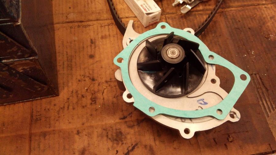

b1- TASC Service-
“The Blue Elephant” My Safari 4x4 Review & Mods

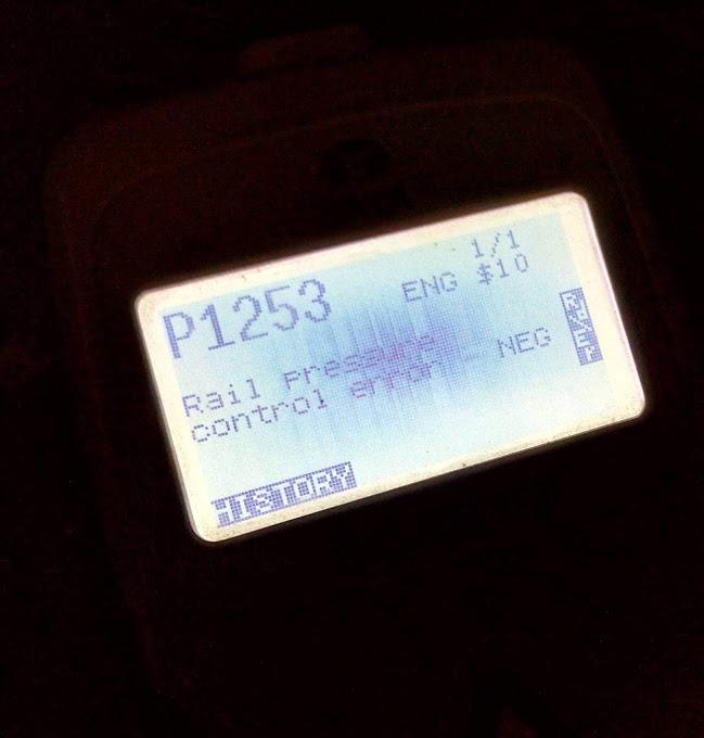

b2- OBD fun-

B. Repairs and mods-
b1- TASC Service-
74k Service-
Jobs done-
1. Timing belt, Cooling pump, Tensioner, Idler etc everything new (Proactive Peace replacement)
2. Sorting out Limp Mode
3. Suspension renew (Front & Back)
4. Sorting up MIL
5. power window & Mirror adjustment buttons repaired.
Service experience-
The first thing I wanted to do after bringing the Elephant home was getting complete service done. I had heard about sudden timing belt failures on these models of 2.2 Dicors (With Catastrophic Failures both mechanically as well as a disaster for wallet) which could cost upto 1.3L to sort out. So That was high on the list. Got it done for roughly 10k including Coolant change. I was also happy that my old timing belt was in tip top shape with no fraying or wear. Still replaced at my will.
Next came was the Limp mode. It was getting really on the nerves. I dropped my car for 3 days at TASC dhule to get it sorted. And they did. The Initial diagnosis was some vacuum lines had jammed/Conked off, causing limp. I was really happy they could bid it goodbye for once and for all!
There is still one more error code- P1253. Which will require further investigation (Skipped for now) The Limp was being caused by P1254 which was sorted.
Next, They also updated the software on Factory Immobilizer as it was having some trouble recognizing the key (Relays would click but would'nt start). That was also pleasant.
Now, Since the SUV was going to stay with doctors for about 3~4 days, I thought I could get done entire suspension replacement. The steering was vague at best. There were heavy vibrations upon changing directions or Sudden braking. Basically the whole front end would nose dive on braking. There were vibrations past 80 KMPH and brakes were very poor. So got front & rear suspension re-done for an expense of about 30k. This includes Front wheel bearings, Hub greasing, Ball joints, Shim adjustment, All bushings and arms.
Also Got All front and rear DIFF Oils changed. Gearbox Oil Changed.
Please note that most of these replacements are proactive and could be skipped. But the peace of mind matters.
Entire bill came somewhere in the range of 45K more or less.
