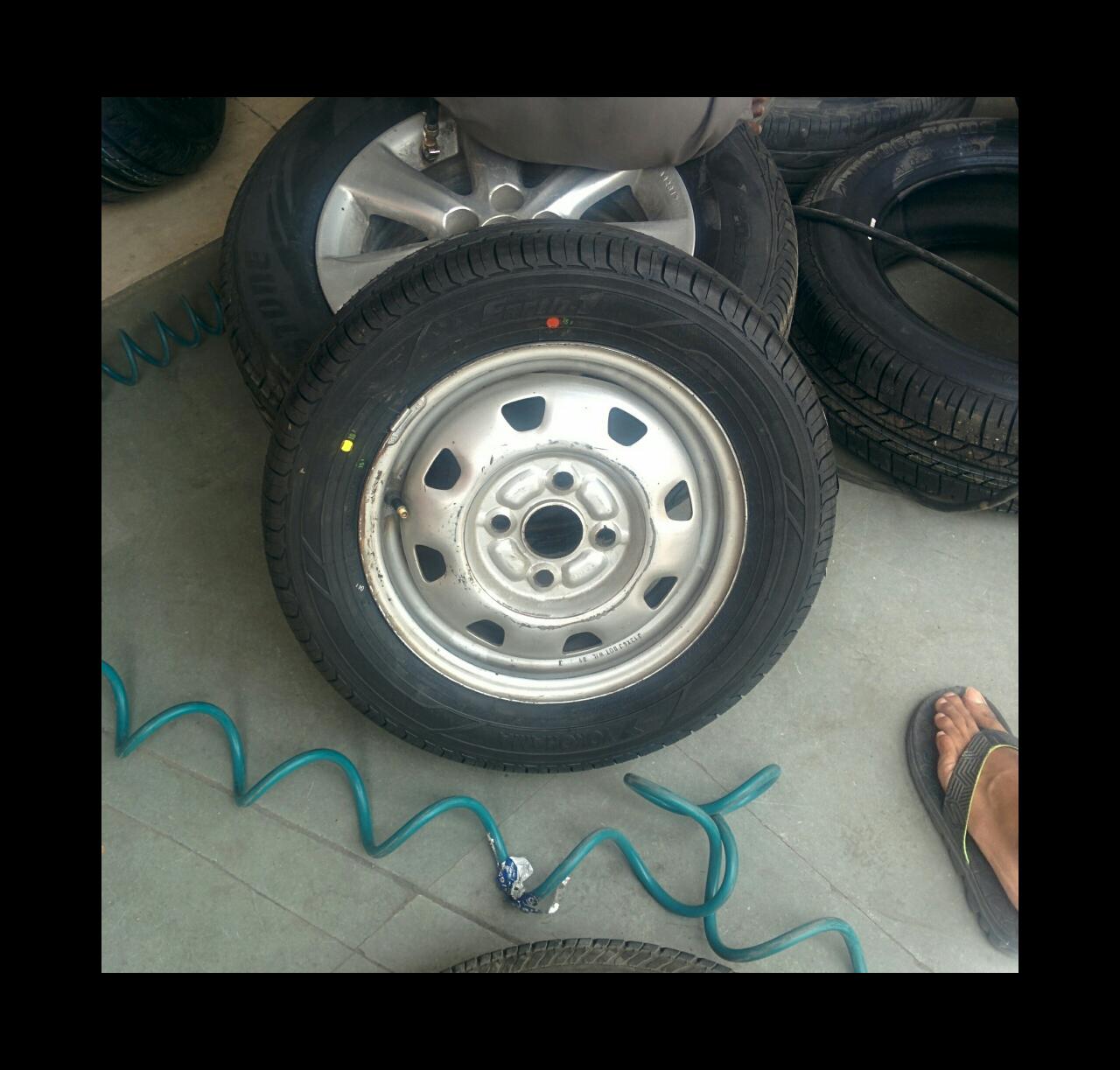

So got the tyres replaced in my santro. I gave i10 for service so took the santro first for tyre replacement.
My relative's shop was closed. Like i mentioned above he quoted 3150 for earth 1 but i got from another shop for just 3000rs per piece. :/ anyways here are some pics.
Cost.
4 yokohama earth 1 155/70/R13 - 12000 rs
Alignment balancing - free
Weights - 340rs
2 tyre nozzles - 200rs (is it really 100rs per piece :/)
Old tyres - 300 rs
So paid 12200 rupees.
Drove the car around 40kms today and i must say the grip has been improved a lot. Even the steering feedback improved.
Done at 130600kms. Let's see how much they'll last. Will update it here.
And he quoted 3100rs per tyre for the i10. 155/80/R13

Congrats.[clap] Good looking thread pattern [:)]
Sometimes he might have planned to give you a surprise Discount while purchasing the tyres. [lol]
