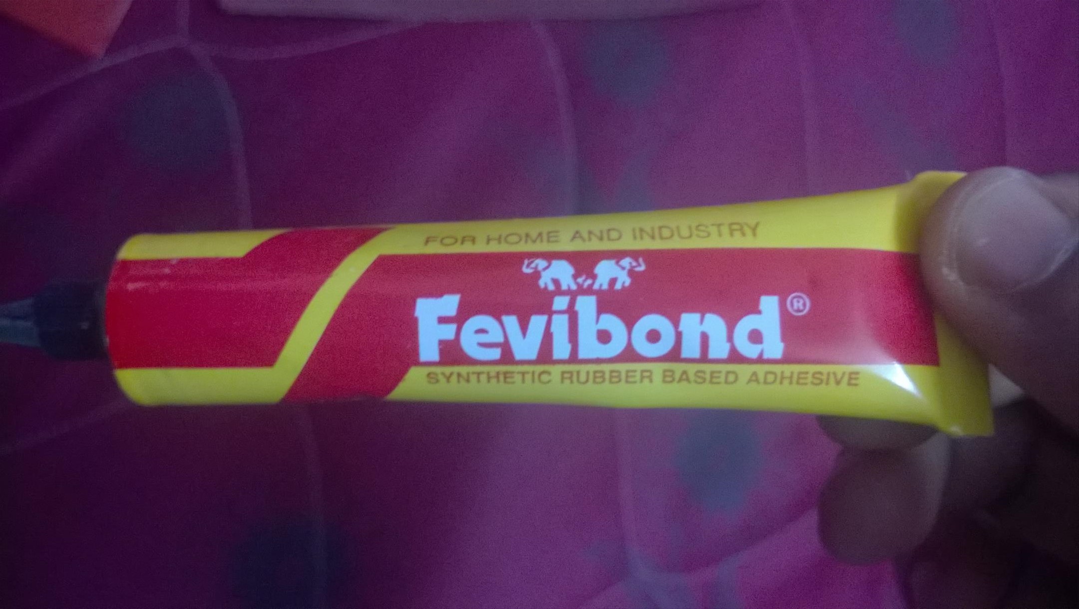

2. Fevibond Adhesive (trust me, buy only this. Feviquick is not great for this purpose)

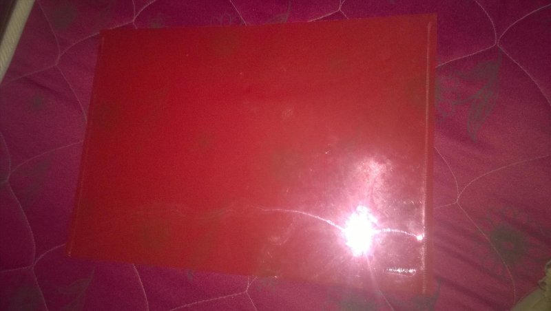

Step 1: Cut the file at its jointed edges so that you get a flat sheet like below

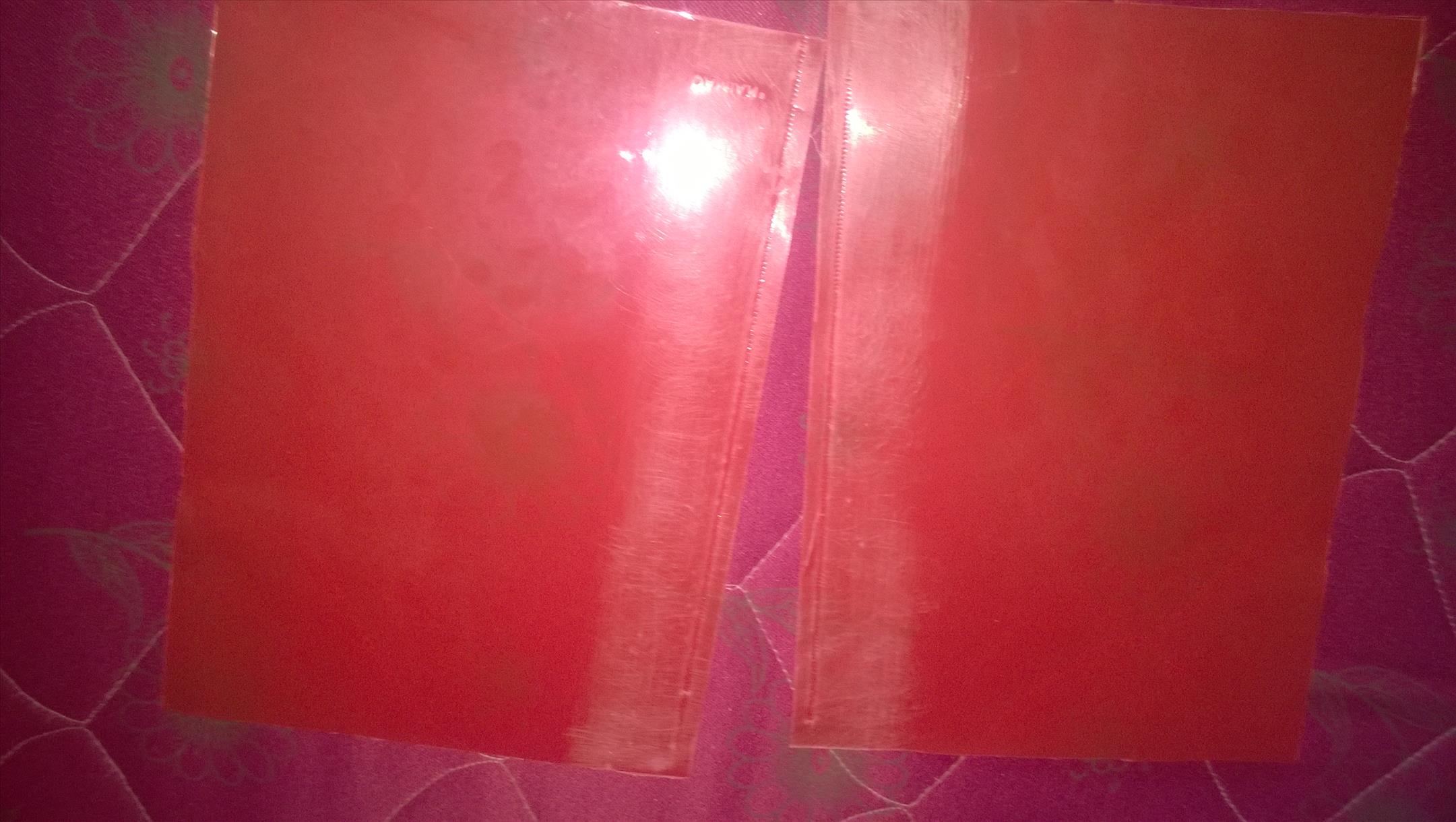

Step 2: Fold and cut the sheet right in the middle so that you get two equal sized sheets
Step 3: Rub with sand paper on bottom edge for around 1 inch thickness on both sheets.

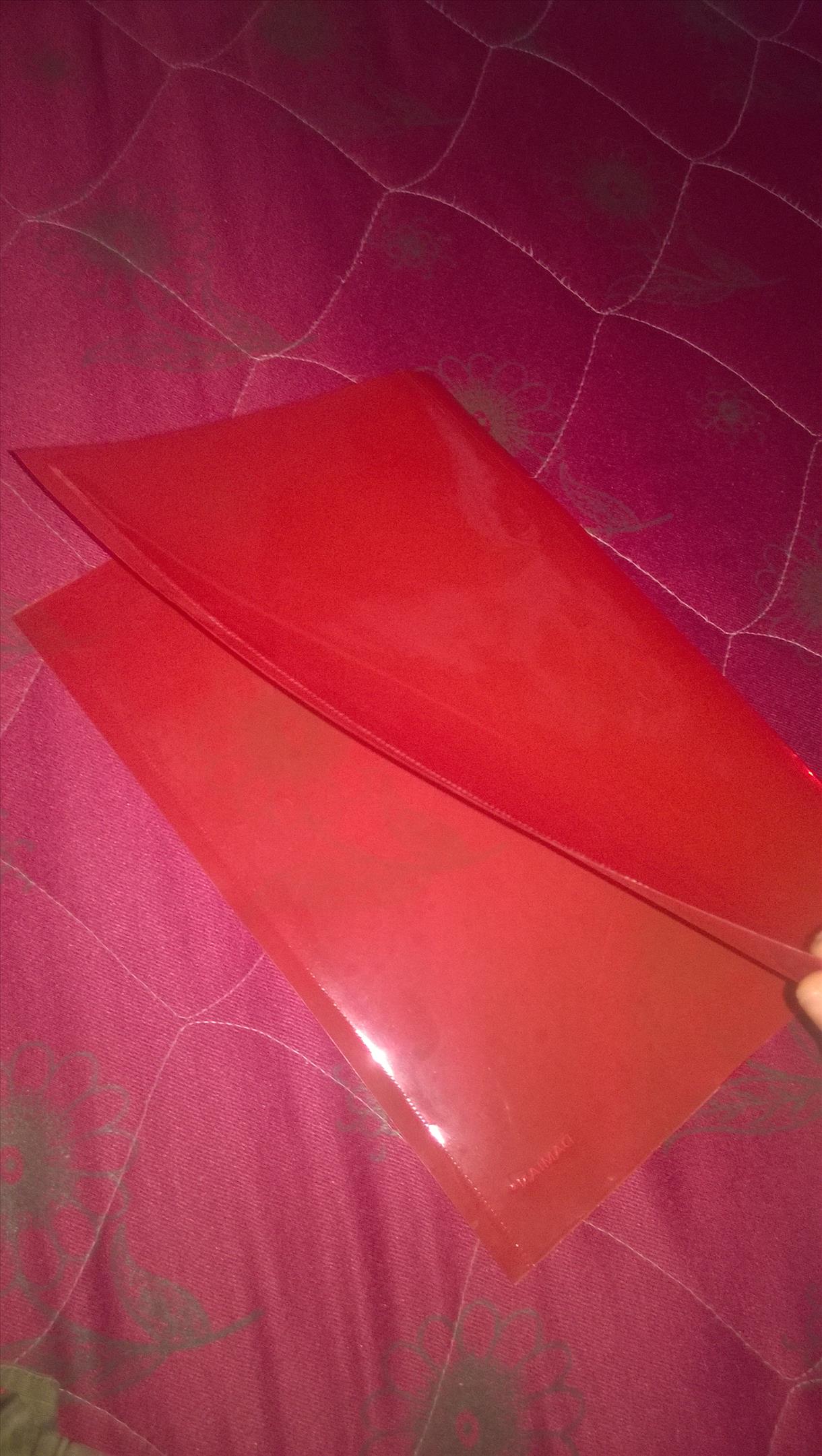

Step 4: Keep a few pieces of file like below. It will be needed later.

Step 6: Apply Fevibond on both surfaces. This adhesive have to be applied on each surfaces and then leave for 10 mins. While applying, use the small pieces of plastic file(step : 4) to evenly spread the adhesive. Inside rim its difficult to apply the adhesive without these plastic flaps.
Step 7: Its the final step of sticking the flap, and its most crucial.
Keep in mind that this adhesive after 10 mins of application, will stick immediately to the other surface.
So you wont get a chance to re position it. So make sure before you press them together, you have placed it in the right sport.

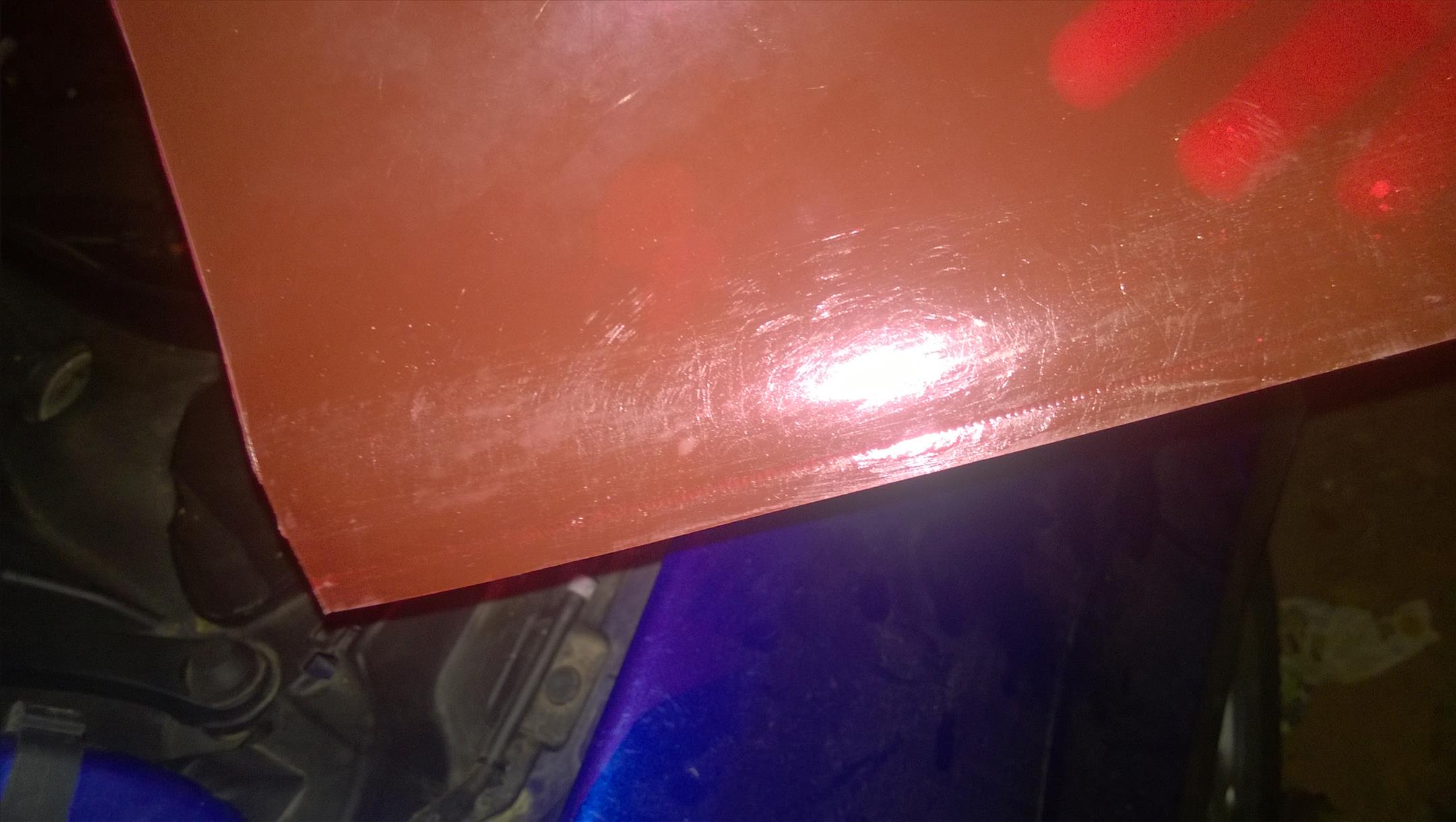

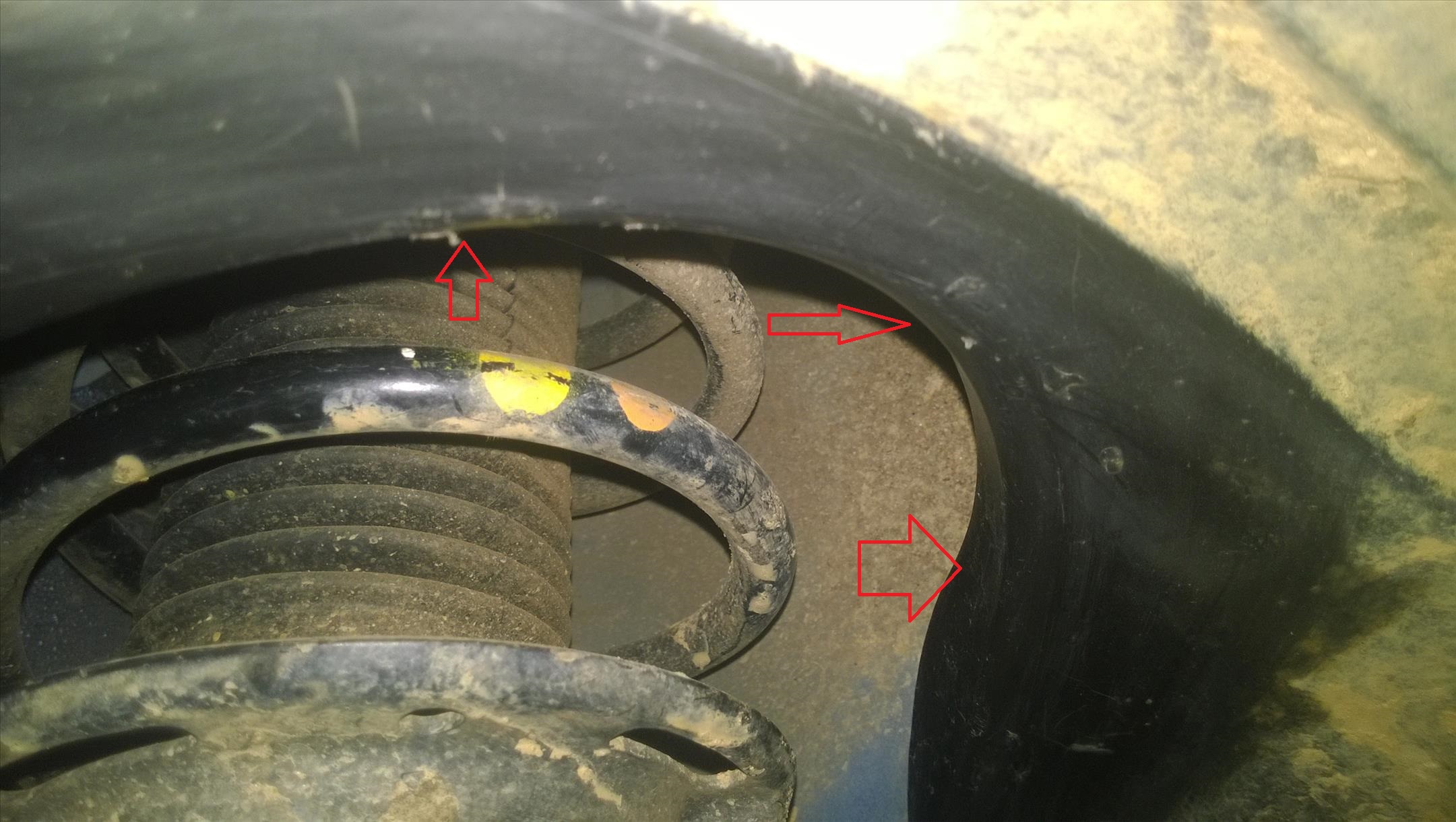

The idea is to cover maximum of the front part. one side of the flap should be reaching till the area where plastic wheel well rim ends. (In the below image where the red rectangle box is drawn, that location should be stick-en by one edge of the flap and the other side should make a semi circle around the suspension without touching it)
Once it seems in the right position, press the flap firmly to the rim at all point of contact.
In the correct position, the flap bottom edge will be perfectly inside the rim till the edge of wheel well.
Leave the car for 2-3 hours.
Thats it :cool: Now, just verify that things are in place.

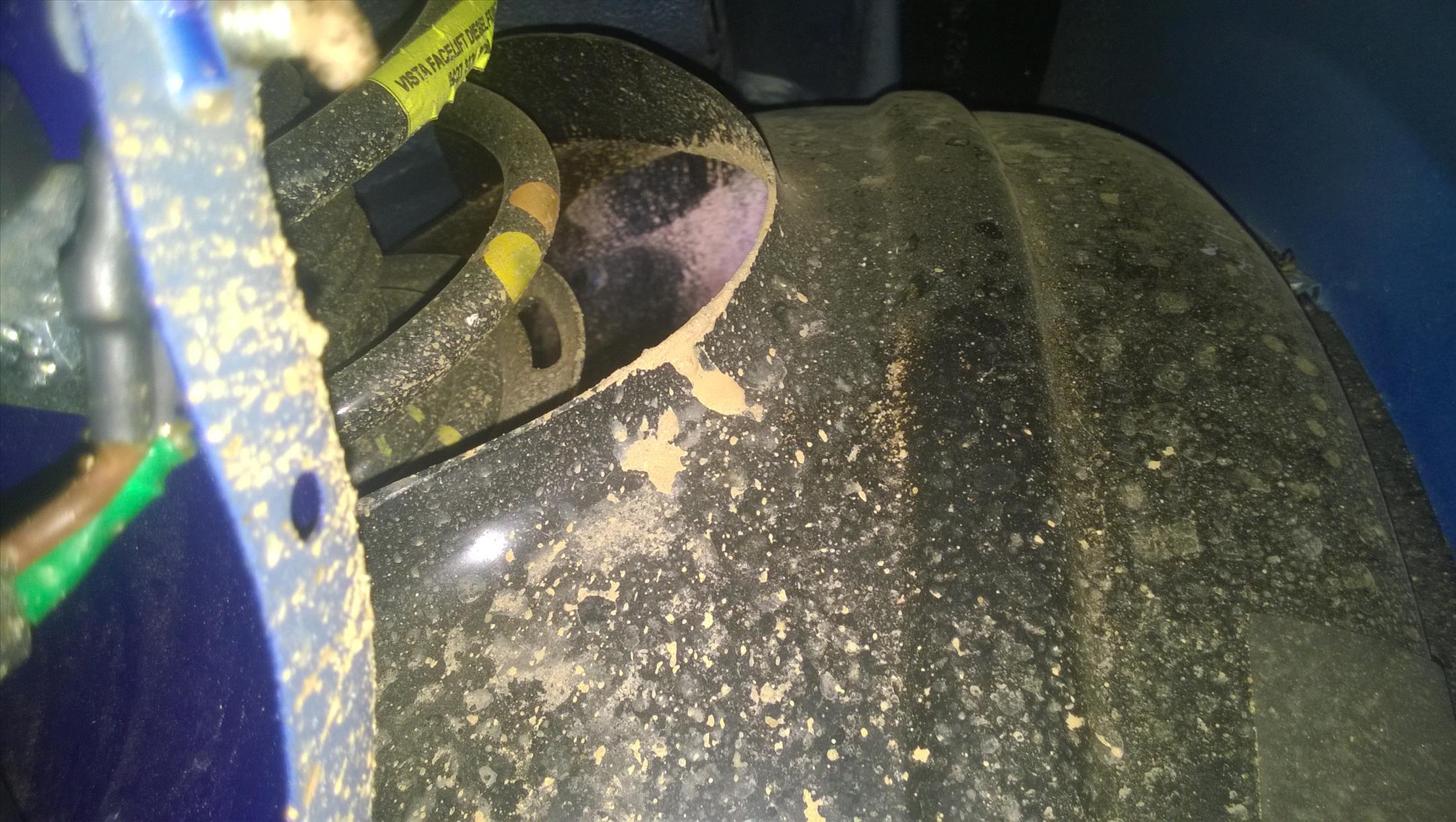

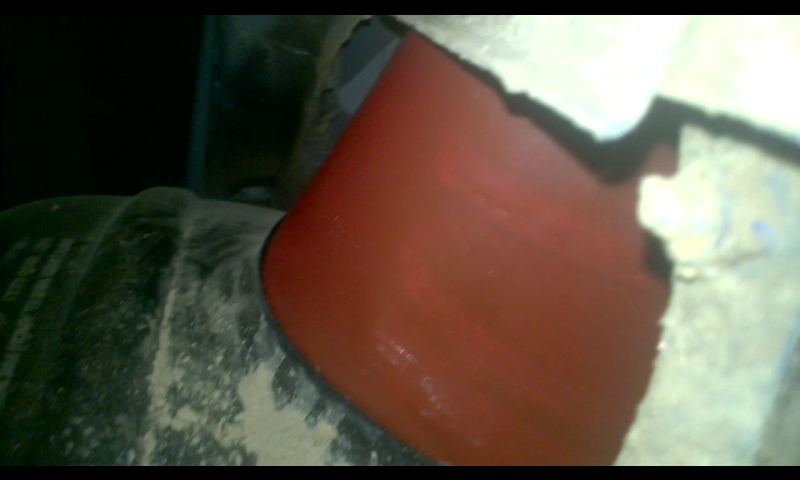

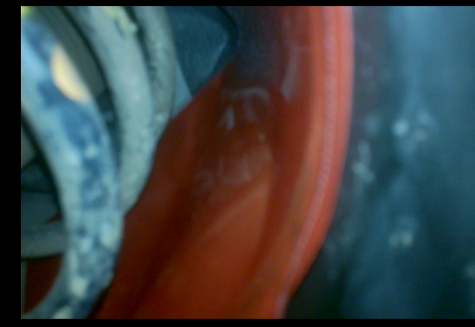

open the bonnet and put your hands with a phone cam in video mode(with flash on) inside the small opening on the side of battery behind the head light assembly.
Take out and watch the video. You should see something like this before and after.
From the wheel opening, if you look up, it should look something like below.
I've been running on this fix for more than 500 kms now and can confirm, it works perfectly well. No rattling noises, nothing.
