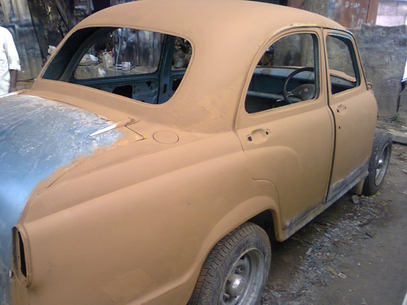

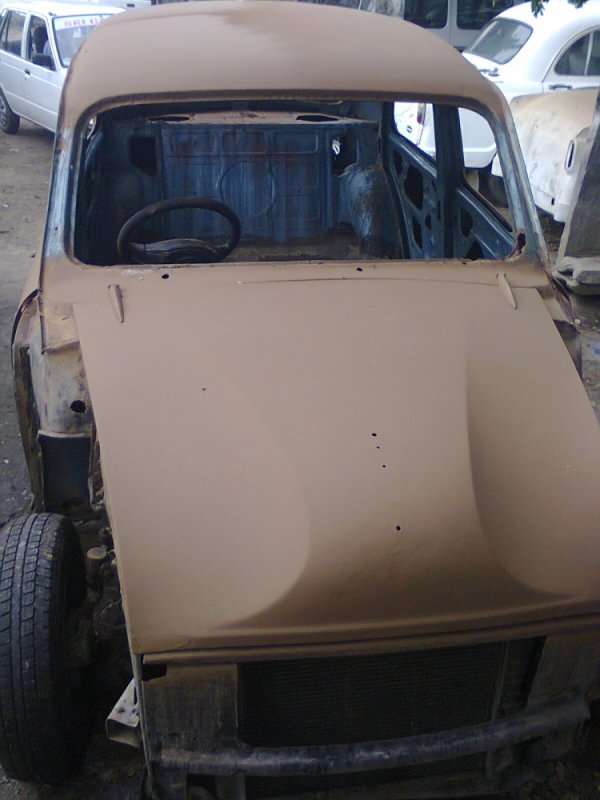

posting some more pics... removed paint entirely and applied primer to protect the shell from corrosion till tinkering work completes

Hi HKS2412, welcome aboard TAI, and a special best wishes for your project on amby. appreciate your love towards amby. keep going.
from the pictures i see, your amby looks perfect and the body lines are also perfect. those corrrosions are regular in all the ambassadors where water gets stagnated and eats away the metal, but other than that locations your vehicle body is in perfect condition. you will not have much to tinker in that body.
if you are confident about your tinker, don't worry, otherwise please monitor closely the work and use onlly dupont products from the base, like metal past, primer etc.,

thank you ambyson for your suggestion. body lines are perfect not much corrosion on the body but water channel above the doors should be rebuild which is very delicate work in ambassador, so not many tinkers dare to touch that part as nowdays expert tinkers are very rare to find, so after a long survey i decided the tinker who is having vast experience in rebuilding ambassador cars.
