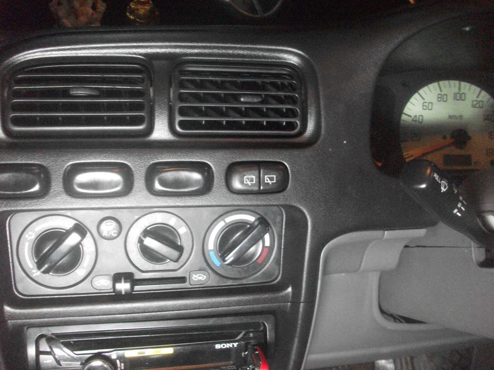

However the trip I had Ooty last time I am decided to fix rear wipe and wash into my car, In heavy rain, there is only one solution to look behind. It is IVRM as both OVRMs are useless and I could only some water drops on the side window glasses.
That is the main reason and I am installed rear wash and wipe into my beloved Maruti Alto. Now the problem almost solved. Yes there is no defogger on the rear glass but put AC blower high speed and the fog will vanish in seconds!
I am sharing some pictures like a teaser because I was busy yesterday after DIY. I am not captured any day time pictures as I was very excited and I don't have a proper camera while working in progress. I will share everything in this weekend.
I am thanking you a ton Varun and one of my other friend Satheesh who helped to drill two holes on my door without any issues.
Back lighting the switch is pending and I wish to change the water spray nozzle as well. The Zen's rear nozzle having only one spray gun and it is broken too. Now its drips water not spraying.

Nice DIY. Share more pics and step by step process?
Where did you procure that switch from ? Its an exact fit to dashboard.

WOW WOW !! Very neatly fixed, how about the wiring ? Do post some pic's of the wiper motor inside the hatch.
You could bend the arm a little bit so that it would look much better.
Luckily wiring was not a big deal :) took a connection from ignition. switch diagram a bit different from you drawn. I tested with multiple connection and find out the correct wires. will bent a little as well
