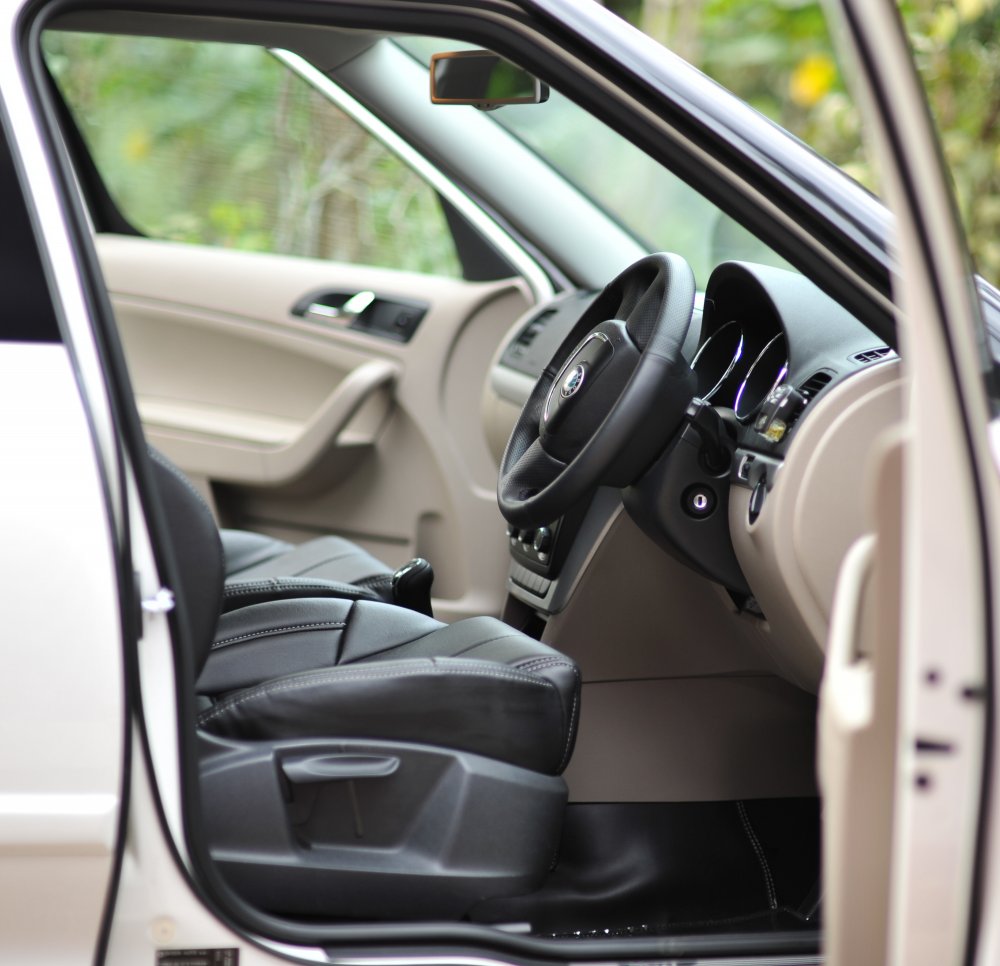

Did a Palakkad-Rajakkad (near Munnar) and back. The Bilstein B6 upgrade has transformed this car into a brute; the Yeti is rock solid at ANY speed now. Did manage to click a couple of images after the first leg of the trip.
The all-new black interior provides supreme comfort in addition to the overall appeal.

Haven’t had time to update this thread with details recently. Firstly, a bit on the work done at Leatherman a few months back. The Yeti had been running with its OE carpet all these years and in Kerala rains when got wet, it produced an uncomfortable odour until it dried up eventually. Wanted to solve the issue with a premium touch and this black leatherette custom stitched to perfection takes it to a new high, both functionally and cosmetically.
The seats were removed and the measurements taken. Pieces were cut and stitched which eventually got spread over the OE carpet.
The Yeti spent one whole day at LeatherMan/Palakkad and it didn’t come cheap either. The Yeti now is the third car in a raw which got leatherman’ed recently. With the additional custom under-thigh and lumbar support, the long drives have become supremely comfortable
