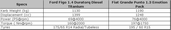

I was just comparing the Figo's and Punto's engine specification.
I know(read) Figo's engine is more powerful, but i want to know how can you make out after seeing the specs?
