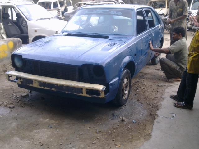

Pics the actual condition when it was found, then serviced and then stages at dentar.
what i did I half scrapped it and not the full paint job as the body was not in that bad in shape. Car has complete blue interior, with original 3 gear hondamatic auto gear running on petrol only.

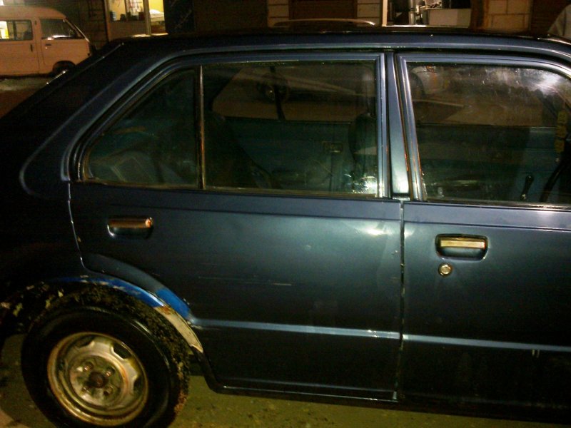

78.jpg Sorry guys was out due to some personal matters.....
further pics added. Some rain happened on the night took some pics. After that some dirty pics in the morning. Please ignore the plastic and rubber ears of bumpers as these were the hardest thing to find and were in living condition since 1981.
Also added some interior pics .....sorry for the result.
