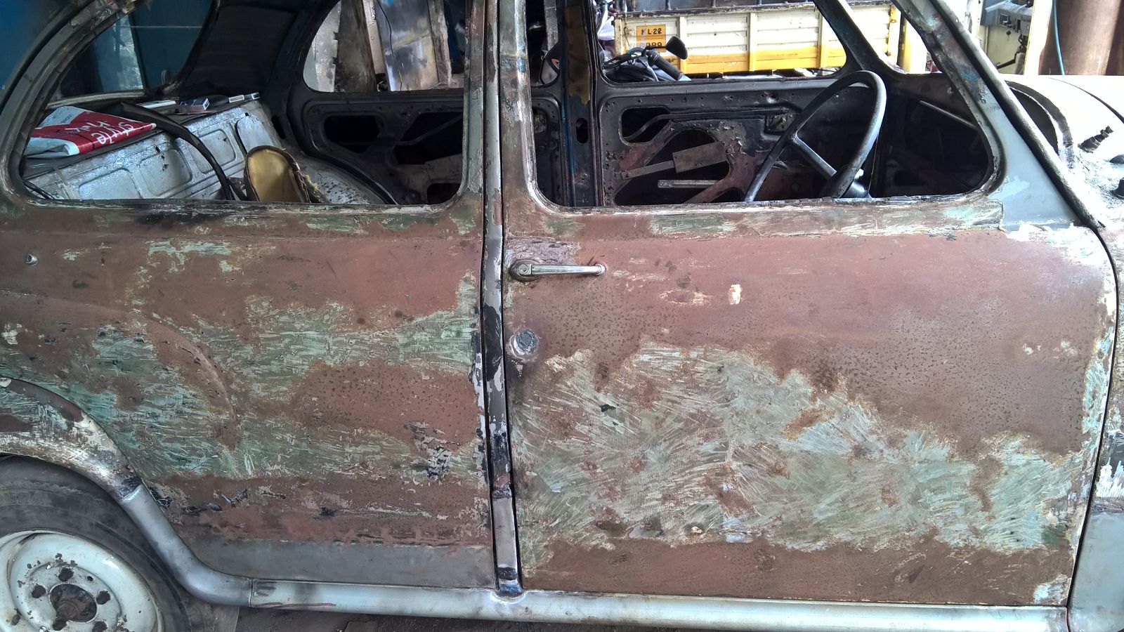

This was actually my grand fathers car.He sold it in 1989.I was in search of this car since 2010,After a looong search,the owner told me that it was scraped one year before.I went to the scrap yard which he told,for my luck it was still alive...in a very much rusted condition.It is a 1965 model,one of the Trivandrum first registration(KLT series )car.
Now it is being patched worked at my native place..il post the pictures of my restoration soon

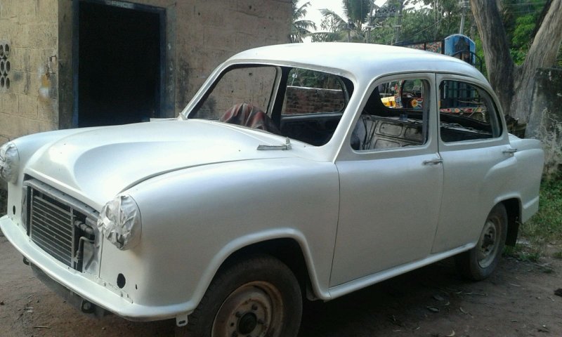

Almost all parts are totally rusted,I met an old patch worker who agreed to repair it.The body is either full of rust and where there is paint,it is full of blisters.He finished the patch work in 7 months.Running boards,platforms,4 door bottoms,wheel arches,door frames....Now the paint is being scrapped out and applied with primer on base metal to check for any blisters recurring

The painter recommended me not to use dupont now,since the body had too much rust deep inside.Even if we did full scrapping of rust till we saw the metal and applied thick metal primer coats,to avoid risks of using high cost paint at first, i decided to use DUCO shell white colour which was original mark2 colour in the 1960s and later on i can switch to a better colour after conforming the body quality.

@unniskrishna, I can see your passion to fully restore this nostalgic piece of family history, please do make sure the chassis is straight before your restoration work begins.
I suggest dont do double work. Change the door outer part, it will be available ready made.
Check the Bonnet, Dick and Water channel and try out the base coat with Duco and leave it sun light for 10 to 15 days and check for final patti and proceed with Dupont itself.
Duco will be less cost, but after one year you may see lot of difference.
Note : Metallic paints were way costlier compared to Dupont normal paint and Dupont normal paint is costlier than the Duco. But Dupont normal and Metallic will be the best one for Ambassador.

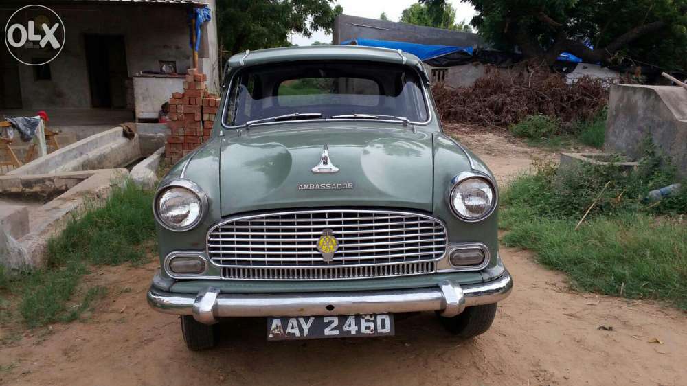

does any one know this green shade exact name?I am restoring my maby into this colour.

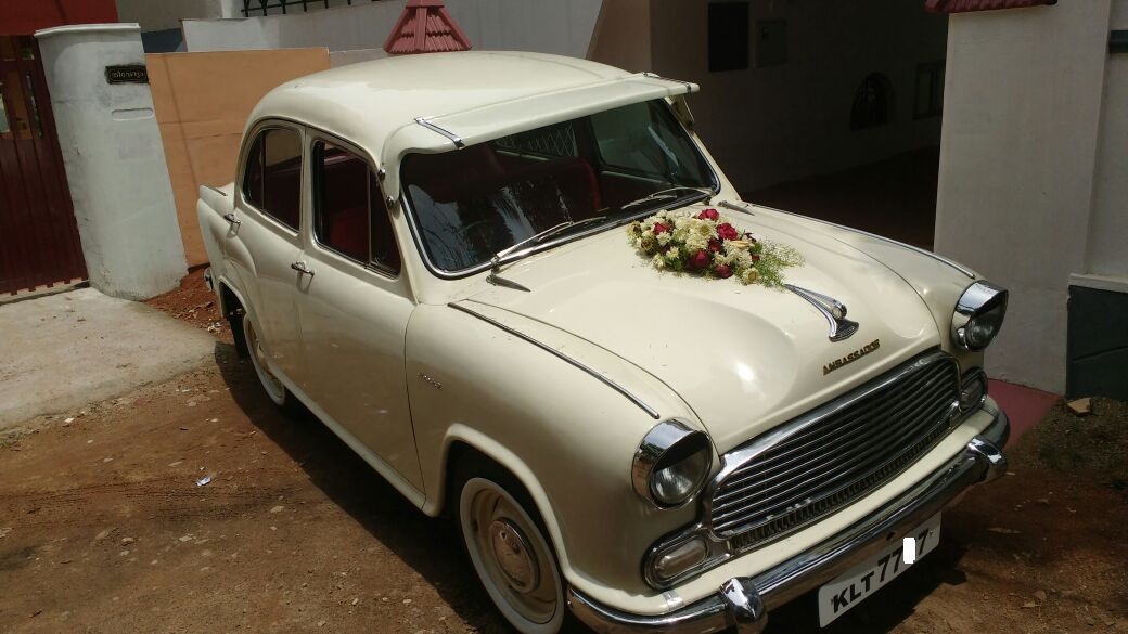

The after almost 9 months the car got ready..It is one of the oldest registration in trivandrum(KLT).i even took it for my marriage.all original parts collected and chromed..steering ,tail lamps front grill and bumpers and beedings collected with a lot of effort
