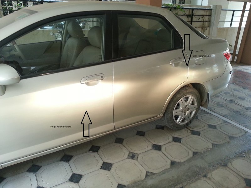

Hi,
I just changed the stock bulbs in my Ecosport with Philips X-treme Vision plus. There is indeed more light from these bulbs. Light is more towards white when compared with the stock bulbs. Road illumination is also much better than the stock's. In the pictures you can clearly see more white light on the left side piller.
